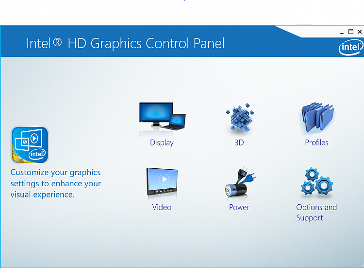

    Intel VT-x Enable?
    I am unable to find anything with Intel Virtual Technology anywhere in the BIOS. I guess the only step is to update my BIOS, but I heard that is very risky. Is there any other way to enable Intel VT-x?
    I have access to my graphics settings but I don't know if that will help.
    msinfo32 - different in VT-x Settings why this, and how to do similar all PCs as the second... 54872d1485961069t-intel-vt-x-enable-capture.png
