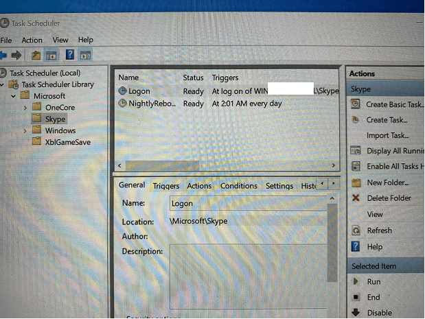

    The MTR device is the same windows 10 OS with custom firmware/software on top. The Task Scheduler is the same, and comes pre-loaded with a setting "NightlyReboot" as you can see in the screenshot. This can be changed from Daily at 2:00 AM to any time that I would like. However, when the system reboots again at any point this setting changes back to Daily at 2:00AM
    MTR Night Reboot, Camera getting grayedout 65753fe7-be49-4173-a170-463d0d136497?upload=true.png
    AVVTC, Mar 7, 2024

    In Windows OS, we have a Task Scheduler that could automatically run Tasks created there. May I confirm you the “Task Scheduler” you’re using is similar with that? Or if convenient and possible, you could share one screenshot of that Task with me here.
    I tried to create one task which will automatically run Teams every one week, and try to reboot computer, but setting remains and doesn’t get changed back. I figure if convenient, you can recreate that task, try to update system and manually update MTR to see if it works. You could create a different task for comparison to check if issue would occur. By the way, there’s one instruction regarding Microsoft Teams Rooms maintenance and operations for your reference.
