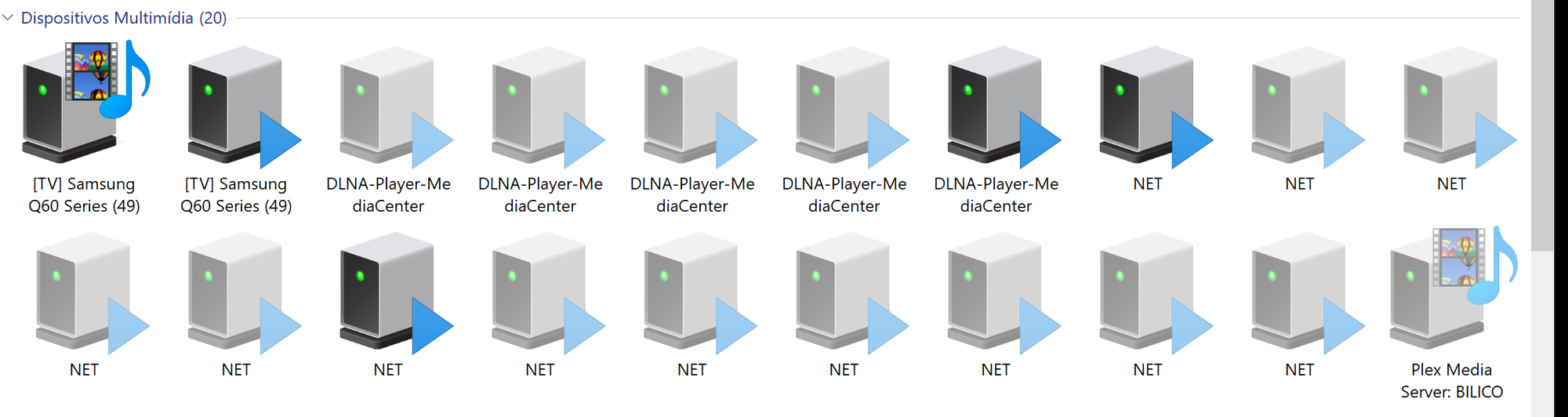

    Hello
    I have here two devices on the network, connected by cable to the router, which are recognized again in win 10 every time I turn on the computer.
    would be: DLNA-Player-MediaCenter and NET
    they were recognized only once in win 7
    check it out:
    Is there a setting for this to stop happening?
    find a way for them to be recognized only once?
    thank you
