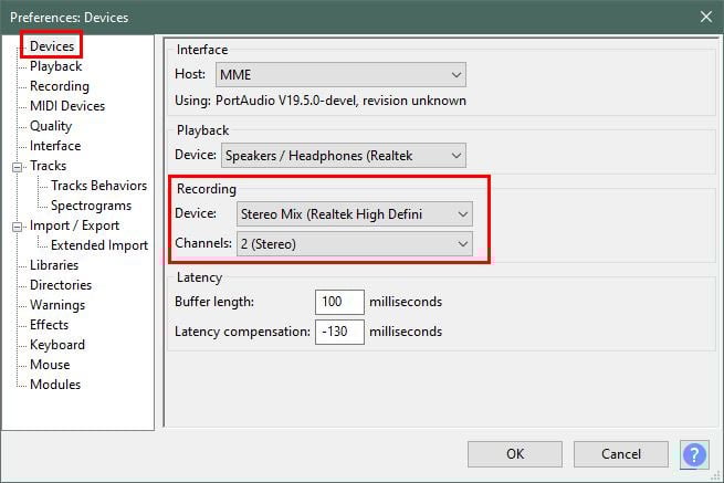

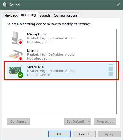

    Audacity should work.
    I've had to fiddle with the Audacity Preferences making sure it and Windows were defaulting to 'Stereo Mix'.
    Audacity Device Preferences:
    My Audio Playback is Muffled by My Mic 283446d1592239431t-how-can-i-record-playback-audio-mic-audacitypreferencesdevices.jpg
    Control Panel > Sound:
    My Audio Playback is Muffled by My Mic 283447d1592239490t-how-can-i-record-playback-audio-mic-stereomixdefault.jpg
