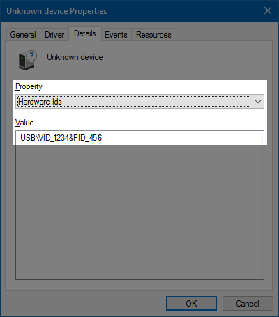

    Also, Bluetooth might not appear in Device Manager if the existing Bluetooth driver isn’t compatible with Windows 10. Follow these steps to find a compatible driver:
    • In the search box on the taskbar, type Device Manager, select it from the list of results, and then expand
      Other devices in Device Manager.
    • Select the unknown device, right click it, and then select Properties.
    • Select the Details tab, and then select Hardware Ids from the
      Property list.
      Look for the hardware ID for the Bluetooth radio. The hardware ID typically looks like this, where
      {ID} is a series of numbers and/or letters: USB\VID_{ID}&PID_{ID}
    • Right click the hardware ID, and then select Copy.
    • Search on the web for the hardware ID you copied to try find the name of the Bluetooth radio manufacturer. After that, visit the Bluetooth hardware or your PC manufacturer’s website to download a Bluetooth driver that’s compatible with Windows 10.
