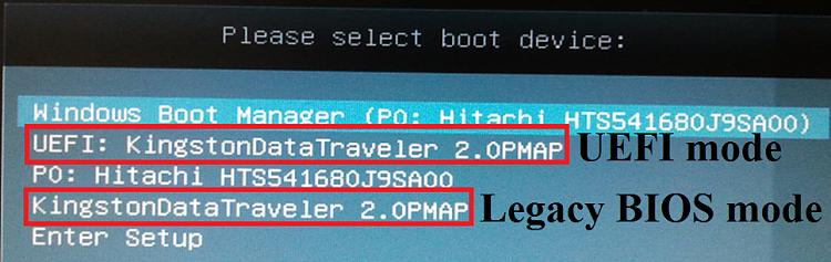

    How to make Windows 10 bootloader As default bootloader
    If you're using UEFI, you might have to use that to edit.
    Modified from here:
    How to set Windows bootloader as default bootloader?
    To repair your Windows bootloader, if you have a Windows CD
    1. Boot from CD
    2. From title screen, open terminal (the button is usually in bottom left corner)
    3. Execute bootrec /fixmbr
      If this doesn't give desired results, try bootrec /fixboot
