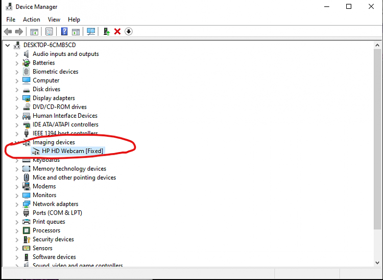

    Look at the attached images:
    My built in HD Webcam on my HP Laptop stopped working and is not appearing on device... 235389d1559090311t-hp-laptop-webcam-stopped-working-driver-problems-annotation-2019-05-29-023504.png
    This is how you see it in device manager.
    My built in HD Webcam on my HP Laptop stopped working and is not appearing on device... 235390d1559090332t-hp-laptop-webcam-stopped-working-driver-problems-annotation-2019-05-29-023552.png
    Maybe you should try to update the driver manually or even choose :
    Let me pick from a list of available drivers on my computer and see if
    you can find it.
