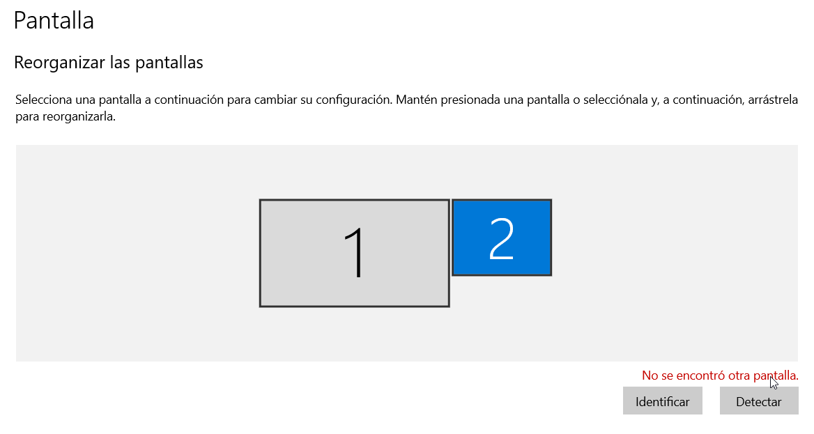

    • Went to windows configuration and tried to "detect" screen, but it can't detect any screen. Here's what I can see:
    Windows can't find the second monitor:
    my computer cannot detect my second screen 64bd5a14-e38b-46ff-8e1e-7fc39bf8dba0?upload=true.png

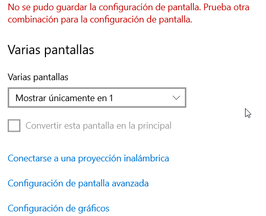

    I can see different options for configuration, but only "show in screen 1" works. The other ones show an error message:
    my computer cannot detect my second screen d2b7f1ab-ec82-498d-b08d-670d569585ab?upload=true.png

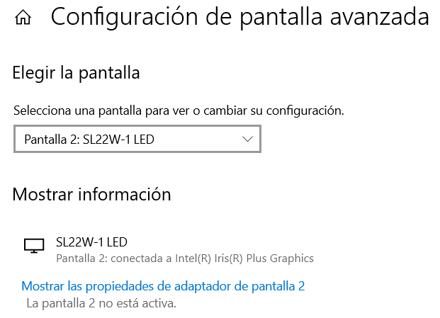

    If I go to "advanced settings", I can find the second screen, but it says it is "inactive":
    my computer cannot detect my second screen c3d9b599-f3cc-4c43-aaae-03782ee98234?upload=true.png
