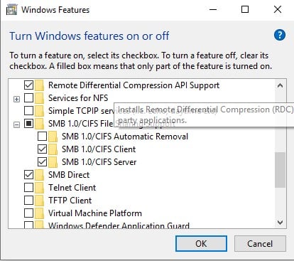

    OK I understand now, This is not an issue with devices appearing as media devices, it is an issue where devices are simply not appearing in the network list.
    Where do you get the "access denied, contact your network manager"?
    I would suggest updating to 1809 - 17763.253
    Just to ensure that you are at the latest release and updates installed.
    As you will have found, there are many posts about this issue and unfortunately there are many proposed resolutions. Enabling SMB 1.0 and the Services listed below normally resolves the issue.
    • Function Discovery Provider Host - Automatic
    • Function Discovery Resource Publication - Automatic
    • DNS Client - Automatic
    • SSDP Discovery - Automatic
    • UPnP Device Host - Automatic
    Older and non compatible devices need SMB 1.0 to be visible on the network and this would need to be enabled on all devices as well not just the PC you are describing.
    To recap....
    Can you see all devices in network devices as you would expect on the other PCs/Laptops?
    Can you ping the devices by IP and by Name? Can you access the PCs via command line \\PCName\Share
    If you have ensured SMB 1.0 is enabled, SMB Direct, as per the image image below
    My computer is having network issues. Despite showing it’s only using 2% of my network,... 222213d1548493567t-2-3-computers-home-network-only-show-multimedia-devices-smb.jpg
    Then I can only suggest corrupt registry settings.
    try running sfc /scannow from an admin command prompt to check for any integrity violations.
    then try and force the settings again, try clearing the the SMB 1.0 and SMB Direct settings completely and restarting, then select them as per the image above followed by a restart.
    Please post back with updates
