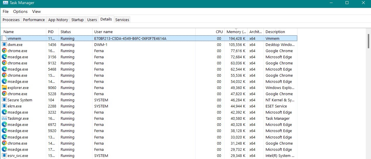

    Could my computer be hacked? Help please
    My computer is running hot due to a process called vmmem.exe.  It is consuming up 25% of... 67ebeacb-92b8-43f1-871f-a860de0dd206?upload=true.jpg

    Hey there!
    Thanks for response. In short - what you are observing - Linux machine that you run with WSL2 runs in context of VMMem process - so if you run VSCode from within Ubuntu - there is no "code.exe" process but it's in context of "vmmem.exe" process - you started
    "code" process inside WSL2 - Linux Virtual Machine, which is hosted by vmmem process - the more you run with WSL2, the more VMMem process will consume resources. Are you able to see this correlation? What happens with usage after you close VSCode?
