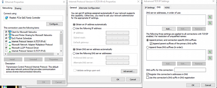

    The first screenshot is as it should be with both DNS and IP set to DHCP, and nothing in the advanced DNS settings.

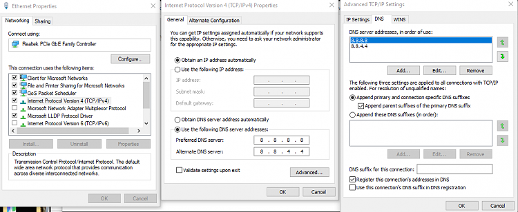

    This screenshot is what I had to change back to manual DNS otherwise I had no internet to post this reply.
    My DNS keeps changing from Automatic to Manual.  Preventing me from accessing the internet.... 394547d1690782935t-perplexed-no-internet-dhcp-dns-but-full-internet-manual-manual-dns-setting.png
    ADDENDUM I just found the problem I had IPV6 disabled but as soon as I enabled IPV6, and with IPV4 DNS and IP set to DHCP, everything worked, so I'm guessing that IPV4 DHCP DNS isn't working, but IPV6 DHCP is working and windows is using IPV6. Oh and my router is the:- D-Link Amplifi HD Media Router 2000 DIR-827
