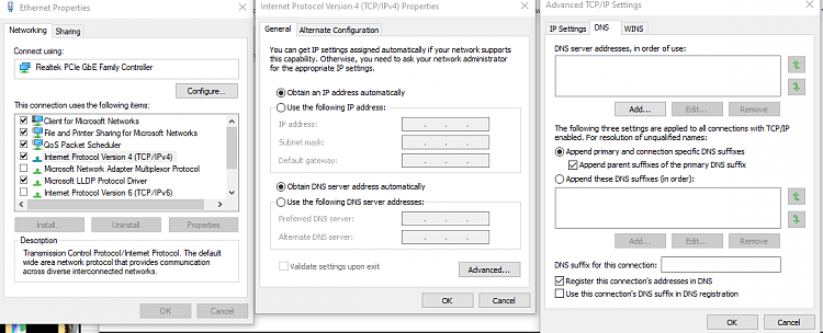

    The first screenshot is as it should be with both DNS and IP set to DHCP, and nothing in the advanced DNS settings.

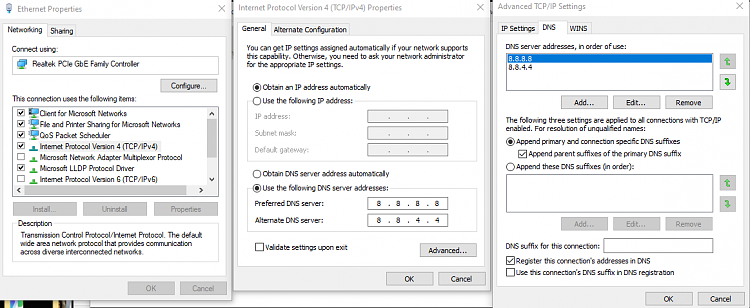

    This screenshot is what I had to change back to manual DNS otherwise I had no internet to post this reply.
