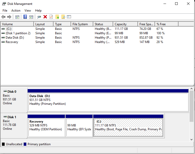

    My EFI System and Recovery Partitions are on the wrong disk Windows 10
    I recently set up a new PC with the intention of having Windows on my new M.2 drive along with the two SSD's for storage. However, I accidentally installed Windows on one of my SSD's first it has the same storage amount as my M.2 drive so I couldn't tell them apart. I managed to get Windows off the SSD and onto the M.2 drive, but the EFI System and Recovery Partitions are still on the SSD instead of the M.2. Is there a way to fix this without reinstalling again?The upload keeps failing whenever I try to insert a screenshot, but you can see my Disk Management hereMy EFI System and Recovery Partitions are on the wrong disk Windows 10 :Disk Management 20231124.jpg

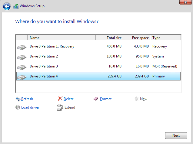

    EFI system and Recovery partitions on wrong drive (I ran a search)

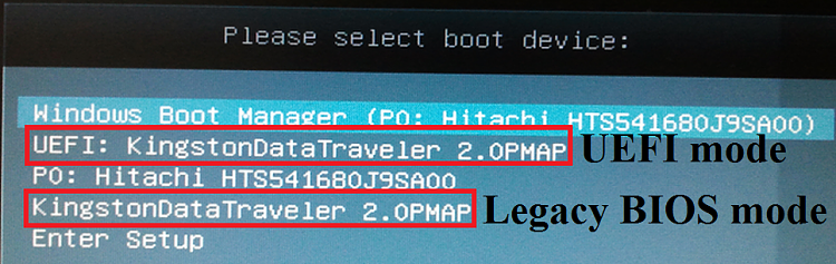

    Depending how the Windows install media is booted (UEFI or Legacy BIOS) Windows Setup creates either GPT or MBR partition style on the SSD/HDD.
    My EFI System and Recovery Partitions are on the wrong disk Windows 10 5975045t-efi-system-recovery-partitions-wrong-drive-i-ran-search-boot-uefi-mode-legacy-bios-mode.png
    The UEFI option will boot the Windows install media in UEFI mode and Windows Setup will create the GPT partition style automatically. On a GPT disk, Windows Setup will create a Recovery partition, an EFI System partition, a Microsoft Reserved partition (won't show in Disk Management) and a primary Windows partition.
    My EFI System and Recovery Partitions are on the wrong disk Windows 10 114544d1485975114t-efi-system-recovery-partitions-wrong-drive-i-ran-search-gpt.png

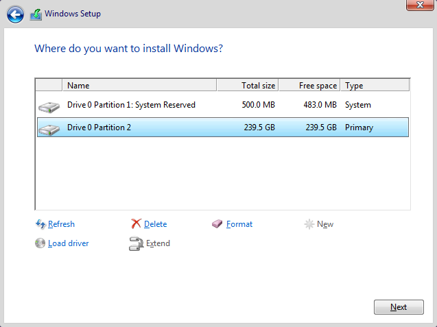

    The non-UEFI option will boot the Windows install media in Legacy BIOS mode and Windows Setup will create the MBR partition style automatically. On an MBR disk, Windows Setup will create a System Reserved partition and a primary Windows partition.

  4. My EFI System and Recovery Partitions are on the wrong disk Windows 10
    Recovery and EFI partition instead of System Reserved partition
    I forced reinstalled my windows 10 after my boot got corrupted by deleting linux on dual boot.
    Now I used diskpart to wipe my SSD before I began installation. When the Win10 installation is finished. I noticed that I have Recovery and EFI Partitions on Disk management. I'm expecting System Reserved Partition because based on some forums, you can only
    get System Reserved Partition if you successfully clean installed the windows 10.
    so that I think I believed that I didn't clean install my Windows 10 because im getting Recovery and EFI partitions.
    Please help how to can i get only System Reserved Partition not Recovery and EFI.
