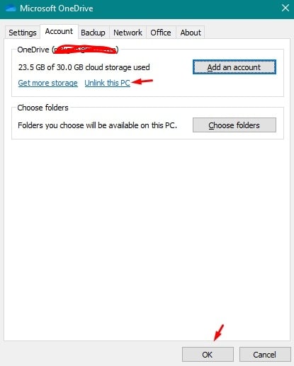

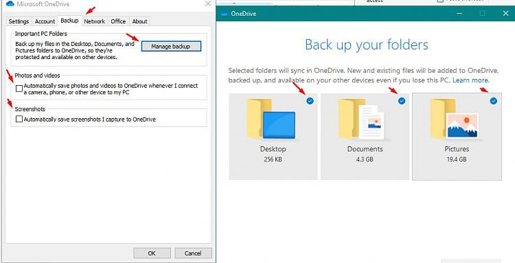

  2. Equation Win User
    How to move everything from Onedrive to Local Computer drive?
    When I disable the backup feature, all my files and files on desktop will be gone when the back up feature is disabled. I had to re-enable backup so my files will be there again.. How can I move my files from onedrive to This PC drive?
    Equation, Aug 22, 2024
  3. Windows 10 - OneDrive
    Right click on the app and one of the properties has an option to not automatically start it. Uncheck, restart the computer, and it should stop. If you want to go another step further, find the OneDrive app in the start menu, right click on it and uninstall.
    If that is still insufficient, there is a batch uninstaller for OneDrive available online. I can copy the code here if you need it.
    FordGT90Concept, Aug 22, 2024
