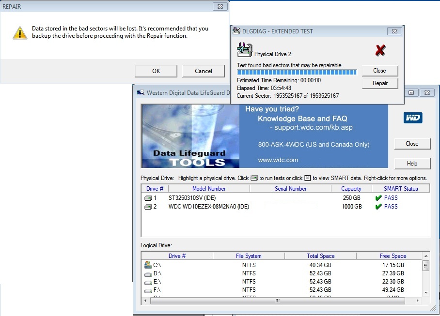

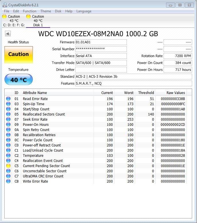

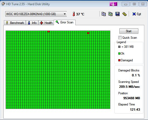

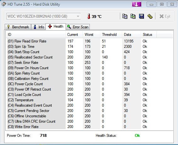

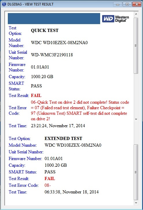

    HDD Health Report: Crystal Disk Info, HD Tune, WD-Data Lifeguard Diagnostics.. pls help
    WD TB Blue - 5 months old.
    Following are the HDD Health Report: Crystal Disk Info, HD Tune, WesternDigital - Data Lifeguard Diagnostics
    Pls suggest.
    Issue: Win7 sometimes started working slow, and then it gets stuct up in safe mode at "CLASSNPN.SYS".

    Crystal Disk Info:
    HD Tune :
    alivehunter, Dec 22, 2020
