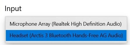

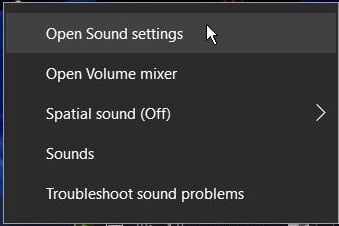

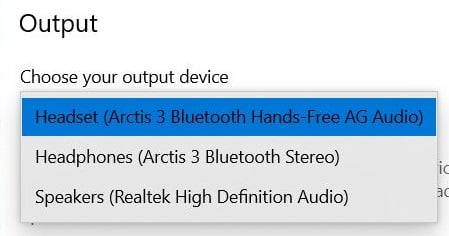

  3. MisterEd Win User
    Computer Won't Use Headphone Mic
    Make sure both input and output are Headset.
    My input/mic takes the output/headphones sound 316351d1611766430t-computer-wont-use-headphone-mic-2021_01_27_16_53_501.jpg
    My input/mic takes the output/headphones sound 316352d1611766503t-computer-wont-use-headphone-mic-2021_01_27_16_55_032.jpg
    My input/mic takes the output/headphones sound 316353d1611766548t-computer-wont-use-headphone-mic-2021_01_27_16_55_484.jpg
    MisterEd, Jan 3, 2024
