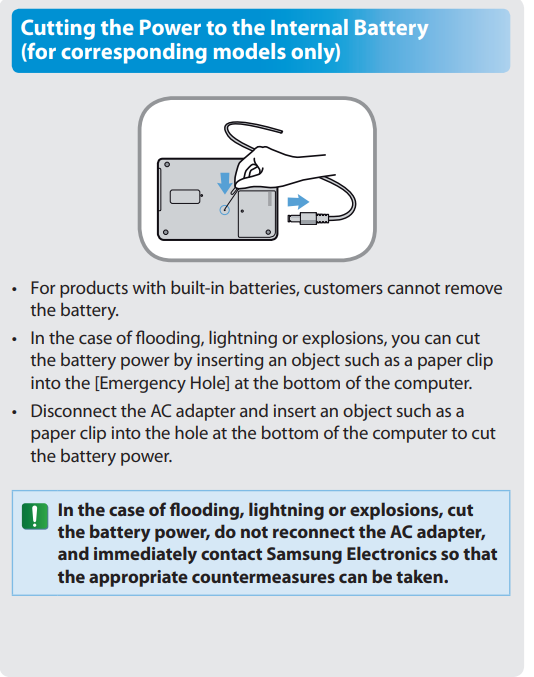

    This is from the ATIV Book 9 Lite manual.
    It suggests there is a battery disconnect hole on bottom of laptop. If pressed it will disconnect battery. Then on reapplying power battery will be connected. This may allow you to reset device. Please confirm in your manual.
