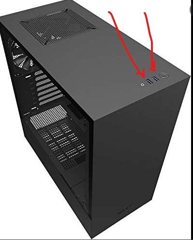

    This is where I initially had plugged the mouse receiver in the front, and once I also insert a USB or HDD next to it, the lagging and freezing starts. Batteries are brand new, so Im excluding this problem. And all Everything is plugged into the same multi power point outlet. So could the motherboard be faulty?

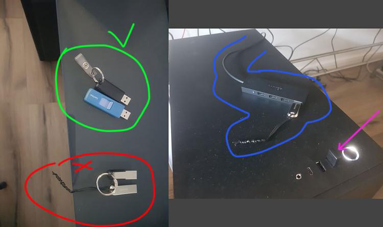

    Hi forum. So here's what I've done so far. And what detail I noticed. The USBs 3.0 (red) when next to the mouse receiver on the pc tower, are lagging. But the 2.0 USBs (Green) don't have an issue. So I got the USB hub and connected it to the motherboard and inserted the 3.0 USB and works well, no lagging issues for my mouse receiver (Purple). I cannot understand what's the issue with 3.0 USBs and mouse receiver but I guess Ill just bite the bullet and accept that its going to be this way for some peculiar reason.
