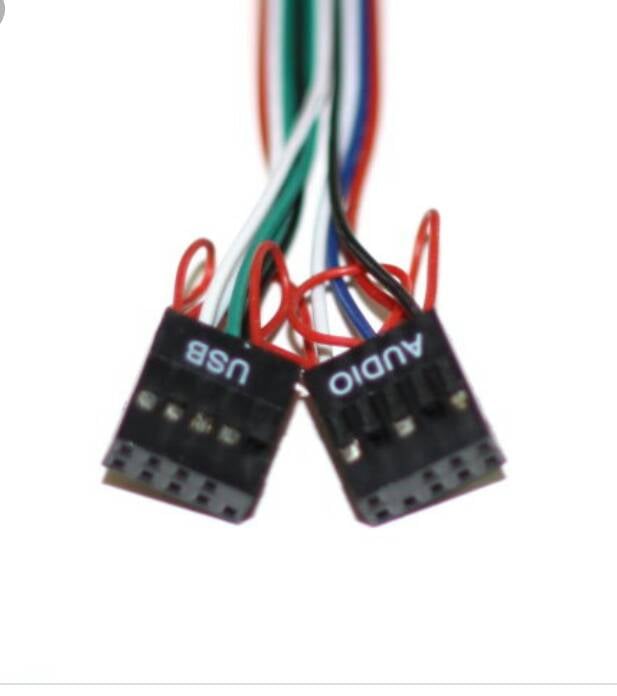

  4. badrobot Win User
    My rear headphone jack is showing as ATAPI Internal Connector in Windows 11.
    Plug broke off in rear speaker jack: front headphone jack disabled now
    There is suppose to be a pin header connector that goes from the front jack to the motherboard. You might wanna check if it is properly connected to the mobo or if it is connected at all.
    It looks something like this:
    My rear headphone jack is showing as ATAPI Internal Connector in Windows 11. lug-broke-off-rear-speaker-jack-front-headphone-jack-disabled-now-screenshot_2018-07-24-00-30-00.jpg
    badrobot, May 6, 2025
