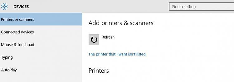

    If you can find out what the IP of the printer is. Here's what I did, it's tucked away in Settings/Devices.
    Click add a printer or scanner in this screen.
    My shared printers are visible on the private network but none of my remote connections can... 30241d1485954161t-cant-connect-remote-printer-p0.jpg
    Then click "the printer that I want isn't listed.

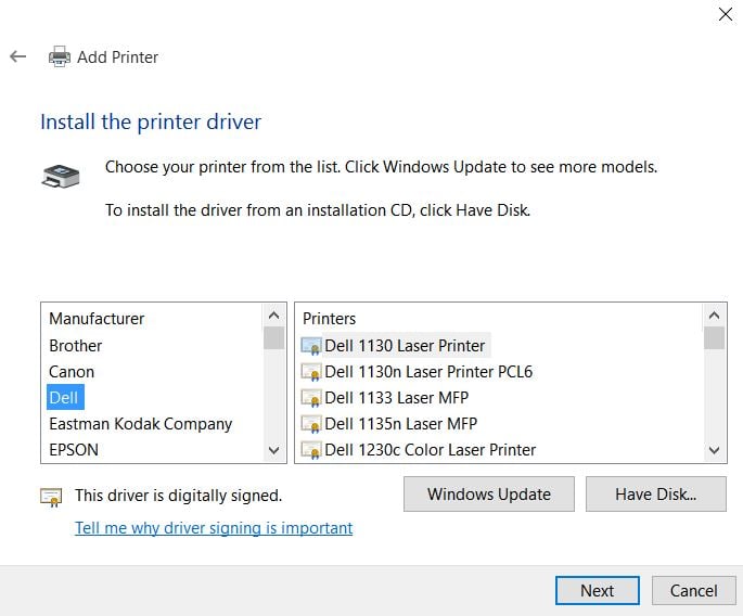

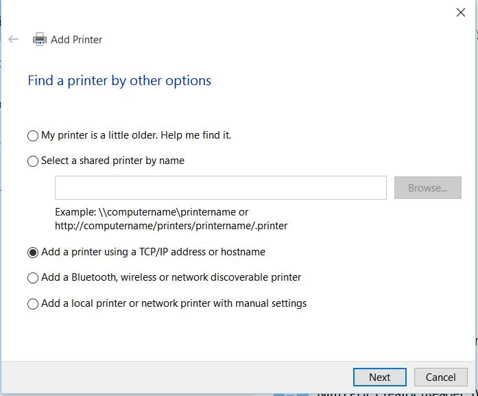

    In this screen there are various options to try.
    My shared printers are visible on the private network but none of my remote connections can... 30244d1485954161t-cant-connect-remote-printer-p2.jpg

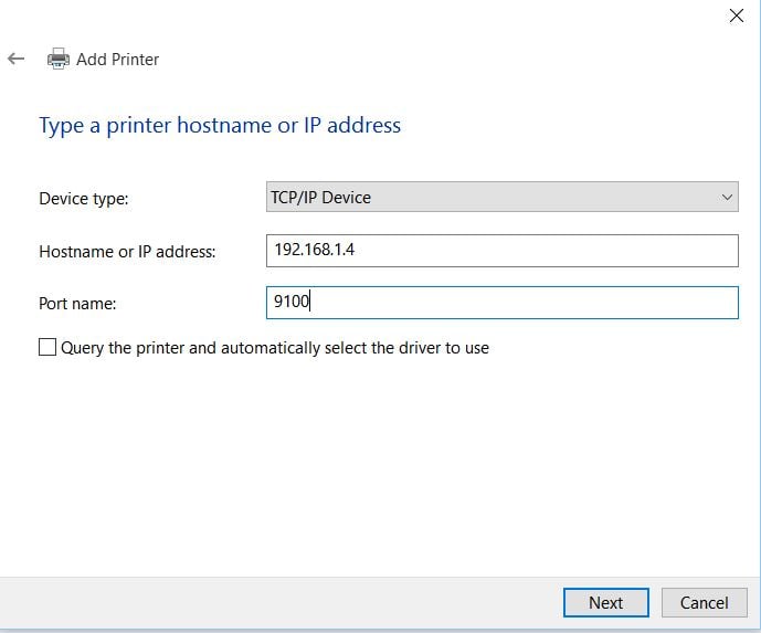

    You can try the IP in both boxes, seems to work
    My shared printers are visible on the private network but none of my remote connections can... 30245d1485954161t-cant-connect-remote-printer-p3.jpg

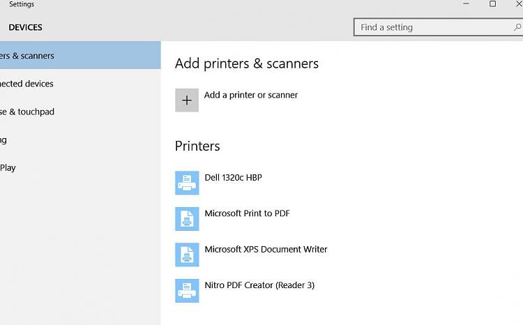

    then hopefully
    My shared printers are visible on the private network but none of my remote connections can... 30247d1485954161t-cant-connect-remote-printer-p4.jpg
