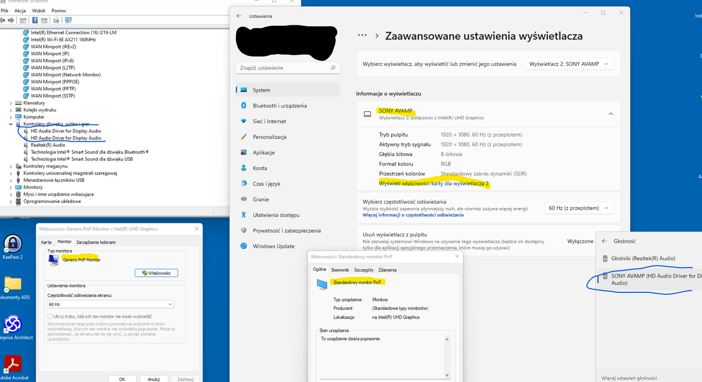

    It seems that windows 11 is behaving differently from win7 and 10 in this particular case. As soon as i plug the laptop to the sony "home theater" via HDMI, SONY it is recognized by the windows 11 system. Proper HD Audio device for Display Audio pops up on the device manager list and there is SONY AVAMP device in audio output list as it shoud be (see below).

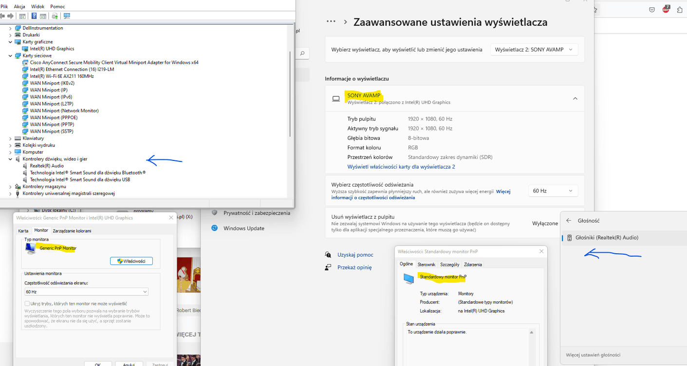

    BUT as soon as i start up EPSON projector connected to the SONY, HD Audio device for Display Audio disaperas from the device manager list and so audio output device. In such case laptop is starting to play audio via internal speakers (realtek AUDIO), video is being transmited via Sony to the Epson as expected.
    My Sony Subwoofer Speaker is not outputting audio to my Laptop 6a4d8a4e-8835-4895-871f-0d0a437d16c9?upload=true.png
    Projector does not have internal speakers. It is like windows 11 is getting by PnP or something info that projector cannot be target for audio and compleatly disregard the fact that there is 5.1 audio system inbetween.
    Once again. It is working perfectly on windows 10 for example or windows 7. I have never had anny issues with this setup till windows 11.
    Any suggestions?
    Michał Śmigielski2, Oct 6, 2023
