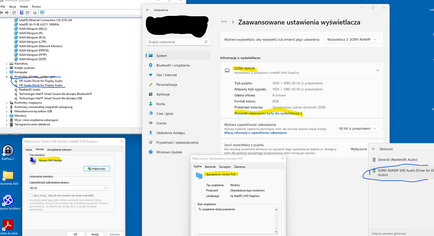

    I've spent several hours going step by step through your suggestions. There is no positive effect. What i achived is adding new Intel driver for the graphics instead of one proveded by the Dell.
    It seems that windows 11 is behaving differently from win7 and 10 in this particular case. As soon as i plug the laptop to the sony "home theater" via HDMI, SONY it is recognized by the windows 11 system. Proper HD Audio device for Display Audio pops up on the device manager list and there is SONY AVAMP device in audio output list as it shoud be (see below).
    My Sony Subwoofer Speaker is not outputting audio to my Laptop f494ced0-7864-44f6-90db-994518d742c8?upload=true.png
