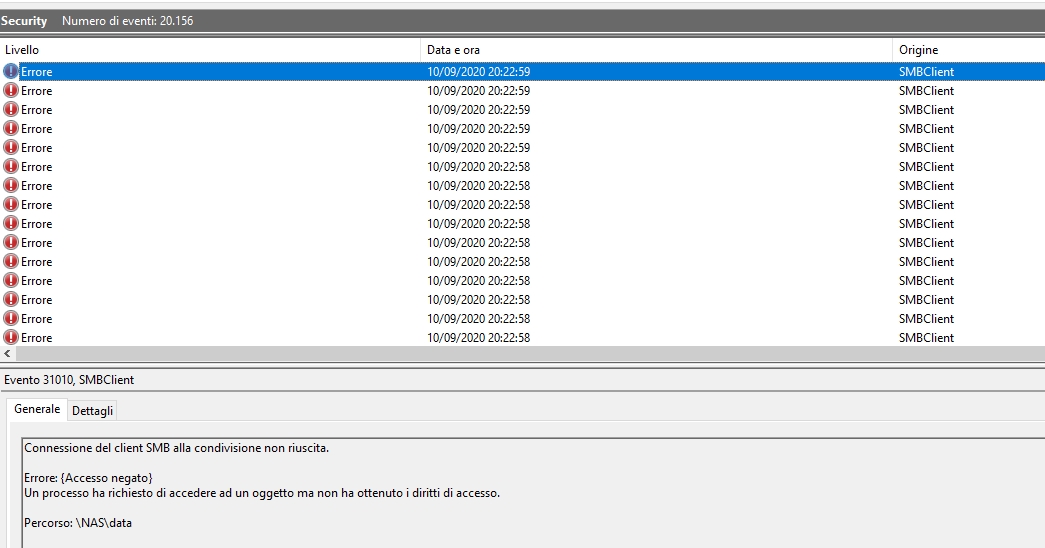

    Everything seems to work fine, but after few seconds I am browsing folders my server is flooded by errors and Windows Event Viewer logs errors under SMB-Client.
    Here's Windows logs. As you might see there are thousands of errors just made in a week.
    Sorry, my OS is set to Italian, the error says:
    Error: {Access Denied}
    A process has requested access to an object, but has not been granted those access rights.
    Path: \nas\data
    Error code: 31010
    My W10 PC is sending anonymous / unauthenticated SMB networks requests 6a422593-7550-4b52-a24a-3ec53a617f63?upload=true.jpg

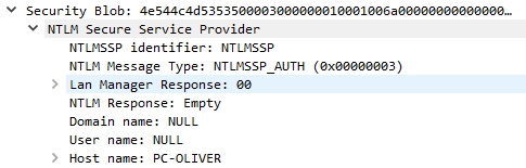

    I also turned on Wireshark and confirmed that my PC is indeed sending empty AuthN requests:
    My W10 PC is sending anonymous / unauthenticated SMB networks requests c24fd1d4-0f63-40ec-b1df-d5d6ca76e0a0?upload=true.jpg
