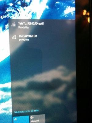

  3. Gorgo Win User
    Wifi stop working. Win10 shows only one network and it doesn't connect
    Product Name: Hp Omen 15
    Operating System: Microsoft Windows 10 (64-bit)
    Wifi card: Intel Wireless-N 7260
    Hi guys,
    since some days my wifi has stopped working.
    If I click on Wifi icon it shows only ONE (max two) NETWORK:
    My Wifi and bluetooth stops working and I have to network reset to make it work again every... 62047d1485962659t-wifi-stop-working-win10-shows-only-one-network-doesnt-connect-medium.jpg

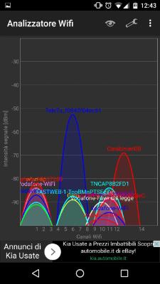

    And I live in a building with 20+ networks, as you can see from WiFi Analyzer (I'm the red one on the right)
    My Wifi and bluetooth stops working and I have to network reset to make it work again every... 62048d1485962659t-wifi-stop-working-win10-shows-only-one-network-doesnt-connect-medium-1-.jpg

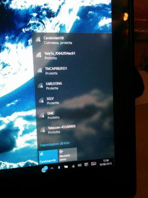

    If I deactive/reactive Wifi with fn+f12, it goes to Airplane mode and to Wifi mode again and it eventually shows all the networks:
    My Wifi and bluetooth stops working and I have to network reset to make it work again every... 62049d1485962659t-wifi-stop-working-win10-shows-only-one-network-doesnt-connect-medium-1-.jpg
    My Wifi is on the top. If it's saved, Windows connects to it and then it drops the connection; if it's not saved and I try to connect, it says "You're not able to connect to this network".
    The fun fact is that after some seconds every network disappear and only one is showed (probably the neighbour one..I dunno).

    Note carefully: If I go close to the router, it shows my network with full power connection and it connects to it. Then I go back to my bedroom (probably 3/4 meters far), it KEEPS the connection for 30/40min and It drops the connection and I can't reconnect to it anymore. It always worked perfectly in my room in these months (I bought it in March 2015), so the distance is not a problem, I'm 6/7m far from the router.
    In this case It shows my Network (Connected) and the neighbour network...and the other 20+ networks???
