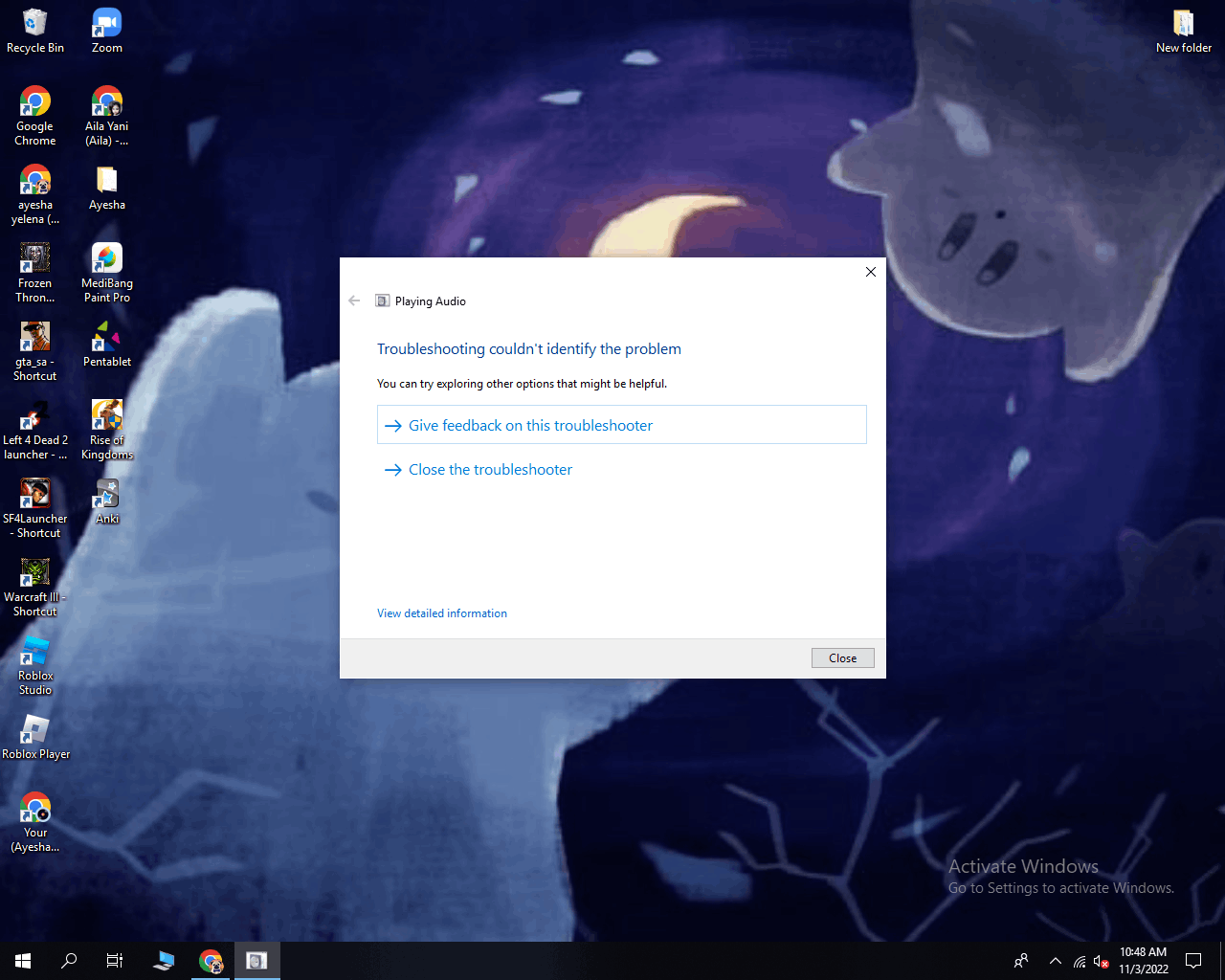

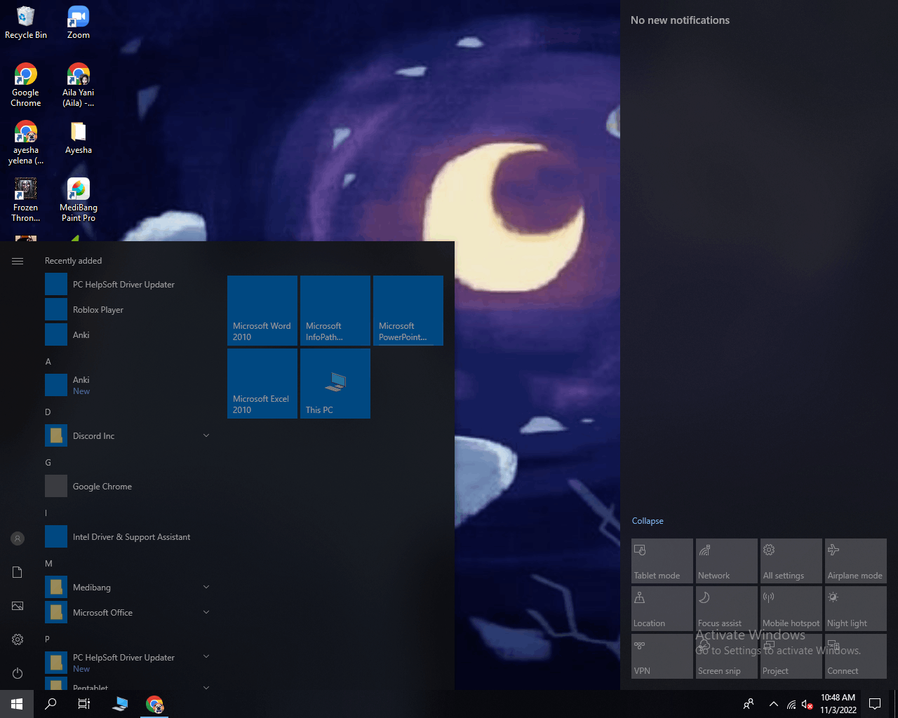

  1. My Windows 10 menu, search bar, notification bar is not responding and my audio is not working
    I recently got the blue screen error, I was able to fix it but after that my menu stopped responding I can open it but after that it will not respond. The search bar will open but immediately close, I can open the notification bar but it will not respond and the audio is not working. Please help!
    Ayesha Leviste, Nov 2, 2022
  2. My Windows 10 menu, search bar, notification bar is not responding and my audio is not working
    My Windows 10 menu, search bar, notification bar is not responding and my audio is not working 456d6fa9-e9e3-4dcb-89df-82656127b60d?upload=true.png
    My Windows 10 menu, search bar, notification bar is not responding and my audio is not working 935f2848-080b-4c5a-b118-b0052c0b8a80?upload=true.png
