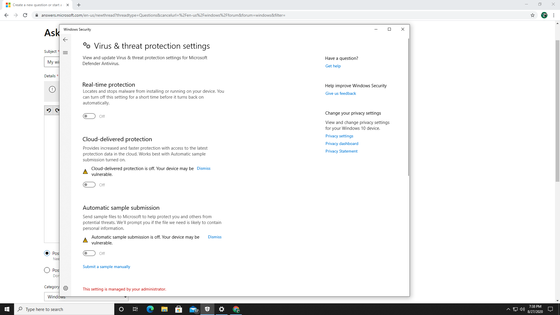

  1. My windows defender is not starting in start up and i cant turn on my real time protection...
    My windows defender is not starting in start up and i cant turn on my real time protection to threats and it says the setting is managed by your administrator, as shown in the photo below: My windows defender is not starting in start up and i cant turn on my real time protection... f00d734c-212b-44c2-b842-fde9c7cf30bc?upload=true.png

    We appreciate your response. We suggest that you try to turn on Windows Defender Real Time Protection from a Hidden Administrator account. To enable Hidden Administrator, the following are the steps:
    • Right-click on the Start button and select Command Prompt (Admin).
    • In the command prompt, type in net user administrator /active:yes and press Enter.
    • Log out and log back in using the Administrator account.
    Let us know if you require further assistance.

    Windows defender real time protection cant be turned on.
    Go to Security and Maintenance, look in 'Security' and see what program is listed under Virus Protection. Windows Defender will not be enabled and functioning properly if there is a program other than Windows Defender listed.
    You tried all suggestions in my previous post and Windows Defender “real time protection”
    still will not turn on?
    Did you try everything suggested in Problems
    starting Windows Defender in Windows 8/8.1/10
    to include (but not limited to) running SFC, scanning for malware and running the software removal tools for any security software (AVG,
    McAfee, Norton, whatever) that may have previously been on the computer followed by a reboot? List of
    anti-malware product removal tools
    Le Boule, Aug 27, 2020

    Unable to turn on Windows Defender real time protection
    Hi guys, I'm a bit desperate here right now. *Confused
    I have the same problem that this guy over here. I'm running Windows 10 Home x64, version 1607, build 14393.0.
    I had to restore the PC to a previous point because I ****ed up some drivers. Then my AV (Bitdefender Free) started having some issues (they gui didn't display correctly) so I decided to uninstall it and just go with Windows Defender.
    The problem is I can't get it to work... I get a notification in the Action Center saying to turn on the virus protection, when I click it, Windows Defender goes green(PC status: protected, Real time protection: on) for a second and then goes yellow again (PC status: Windows Defender is OFF, Real time protection: Handled by another AV program) and I get the notification again. If instead of clicking the notification I click "Turn on" on the Windows Defender gui, Windows opens another window, "Apps & Features" in settings, like asking me to uninstall the other, nonexistent AV.
    Now, I've tried a lot of things...
    • Of course, I have completely uninstalled Bitdefender. I used the official tool provided by them for this. There is nothing in the registry by bitdefender nor any file or folder by that name in my PC.
    • I have tried every step listed here.
    • I have tried to install another AV (Avast) and the uninstall it to see if this would "reset" somehow windows defender. (Nope.)
    • I have run MBAM and nothing pops-up
    In HKEY_LOCAL_MACHINE\SOFTWARE\Policies\Microsoft\Windows Defender there is noDisableAntiSpyware key. But in HKEY_LOCAL_MACHINE\SOFTWARE\Microsoft\Windows Defender there is a DisableAntiSpyware key and its value is 0. (Not sure if this is important but wanted to give you the info.)
    Anyone has any idea? Right now I'm thinking of downloading another AV or just go without any and be done with it. *Huh
    ThunderRoad, Aug 27, 2020
