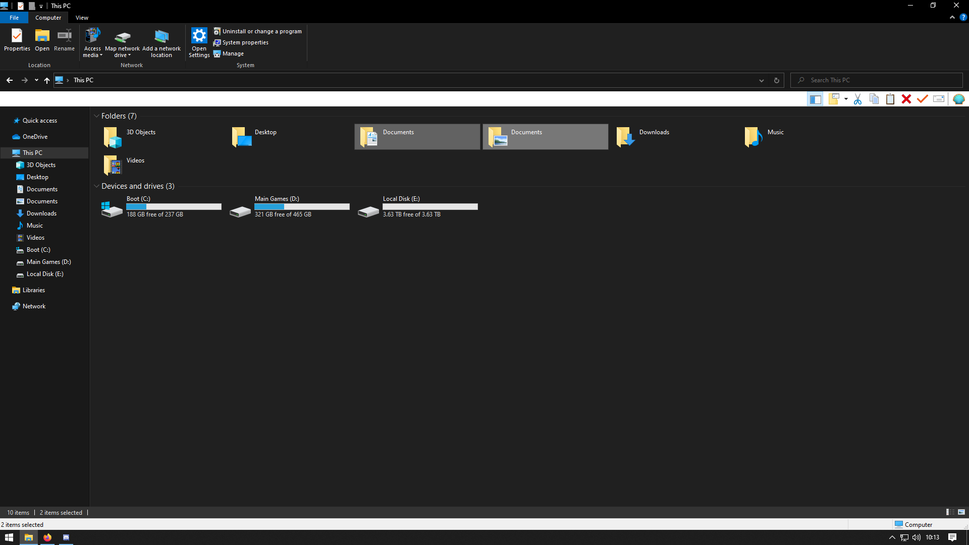

    Hello all, as you can see from the img below, two of my libraries are "kaput" and most locations are that too..
    I attempted to move them all to my E:/ drive... but went wrong somewhere along the line.
    My Windows libraries are all called documents! 2658aff5-629b-4e27-9c82-913fa7066d2a?upload=true.png
    This is the screenshot of my current library, I've found a topic and managed to fix 2 libraries i think?
    but can't for the live of me figure the others out!

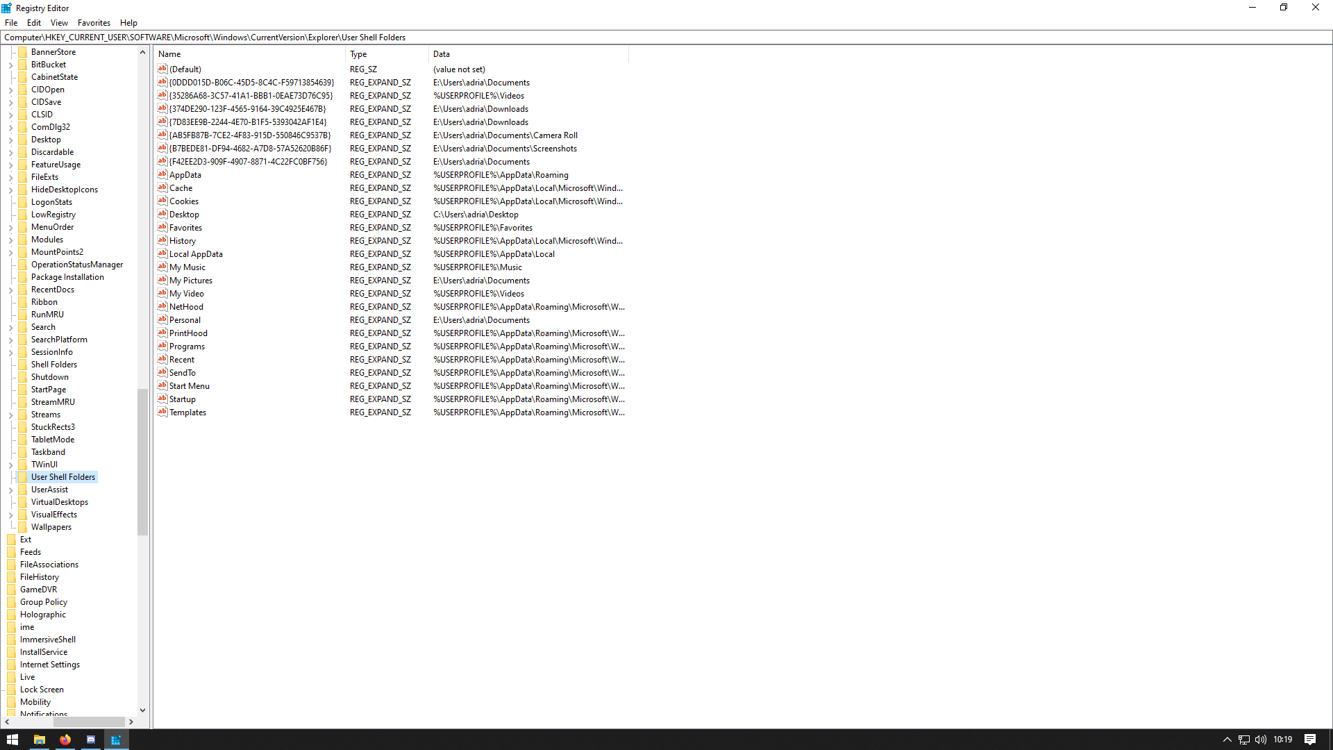

    Ill post another screen of my reg files below:
    My Windows libraries are all called documents! 5568edaf-45fe-4fe0-a3ce-89460081c032?upload=true.png

  4. My Windows libraries are all called documents!
    Delete a Library in Windows 10
    Thank you for being part of Windows 10.
    I appreciate you for providing details about the issue and we are happy to help you.
    I would suggest you to restore the Libraries and then try deleting the Library folder.
    Follow the below steps.
    • Press Windows + E keys from the Keyboard to open the
      File Explorer.
    • Locate Libraries from the left pane.
    • Right click on Libraries and select Restore default libraries option from the list.
    Kindly let us know if you need any further assistance with Windows. We are happy to assist you.
