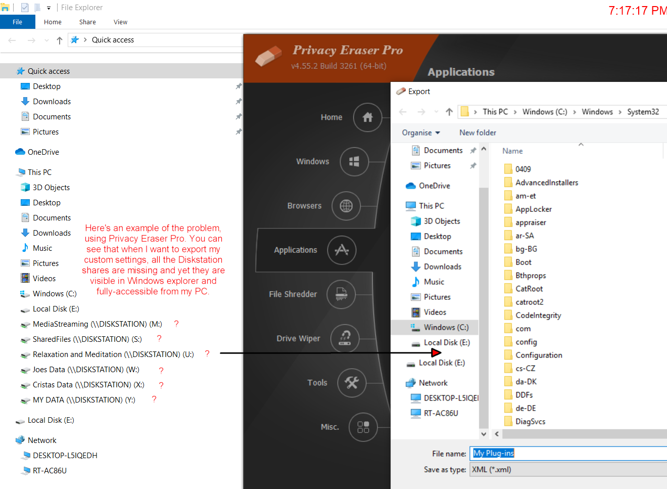

    Recently I have been having problems with mapped NAS shares on my network not being visible in programs. I first noticed it when I was trying to set up a backup schedule. I tried several backup programs, including SyncbackPro, which I have used for many years without any problems. I've also noticed the same problem when trying to export my custom plug-ins from Privacy Eraser. The screenshot I am uploading shows the problem. I can see and access the shares via Windows Explorer as you can see. I have tried the usual things - rebooting my laptop and router; disabling Kaspersky, etc, but no difference. My daughter's laptop is exhibiting the same problem and runs on Windows 10 64-bit as does mine. I have contacted Synology for help and they have written back: "As the mapped drives are showing in File Explorer, this is not an issue with the NAS, but an issue with Windows. I believe the issue may lie with how the drives are mapped as a standard user, rather than an administrator, so when you are using an application, it does not see the mapped drives. I would recommend contacting Microsft about this issue as they will be able to advise further."
    I don't know what else to try. Can anyone advise please?
    NAS shares unavailable in programs ae819b56-dbc5-49a7-905a-ff31084e17ee?upload=true.png

  3. Cannot 'Map Drive' to share on NAS after Windows 10 update
    Just for the record I solved this:
    • Opened 'Turn Windows Features on or off' in Control Panel.
    • Enabled SMB 1.0/CIFS File sharing support
    • Rebooted
    • All shares on NAS can now be mapped.
