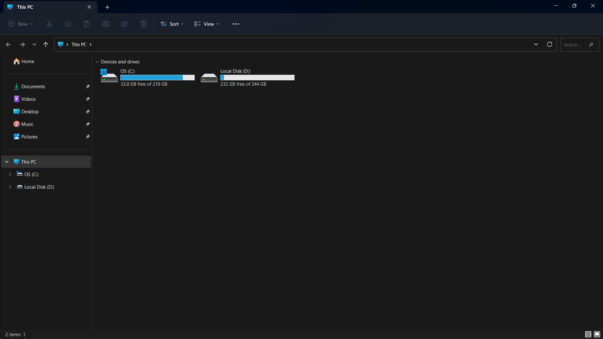

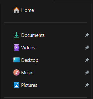

  4. Need help! I accidentally merged the Downloads Folder and the Documents folder while...
    Need help! I accidentally merged the Downloads Folder and the Documents folder while redirecting location
    As the title says, I accidentally merged the Downloads folder with the Documents folder while redirecting the location of the folders from the C:/ to D:/ drives. I can't use File History to restore it. I can't move them back to previous locations or restore the folders to previous versions. It says they are not available.
    I also can't seem to find the Documents and Downloads folder in my User folder. It won't let me create new folders in my User folder either because it will just automatically merge with the existing one with a different path (D:/).
    I tried restoring the User file to a previous version and it didn't fix the issue...
    for some reason the icons for the user libraries is also messed up , like for instance the document folder has the icon for download
    basically the download , and document folder is merged and i cant recover them
    i also lost quick access from the navigation pane
    Help, please?

    Here's a picture
    prajjwal kushwaha, Oct 13, 2024
