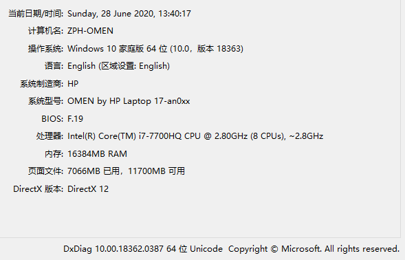

    PC Spec: Apology for the Chinese texts

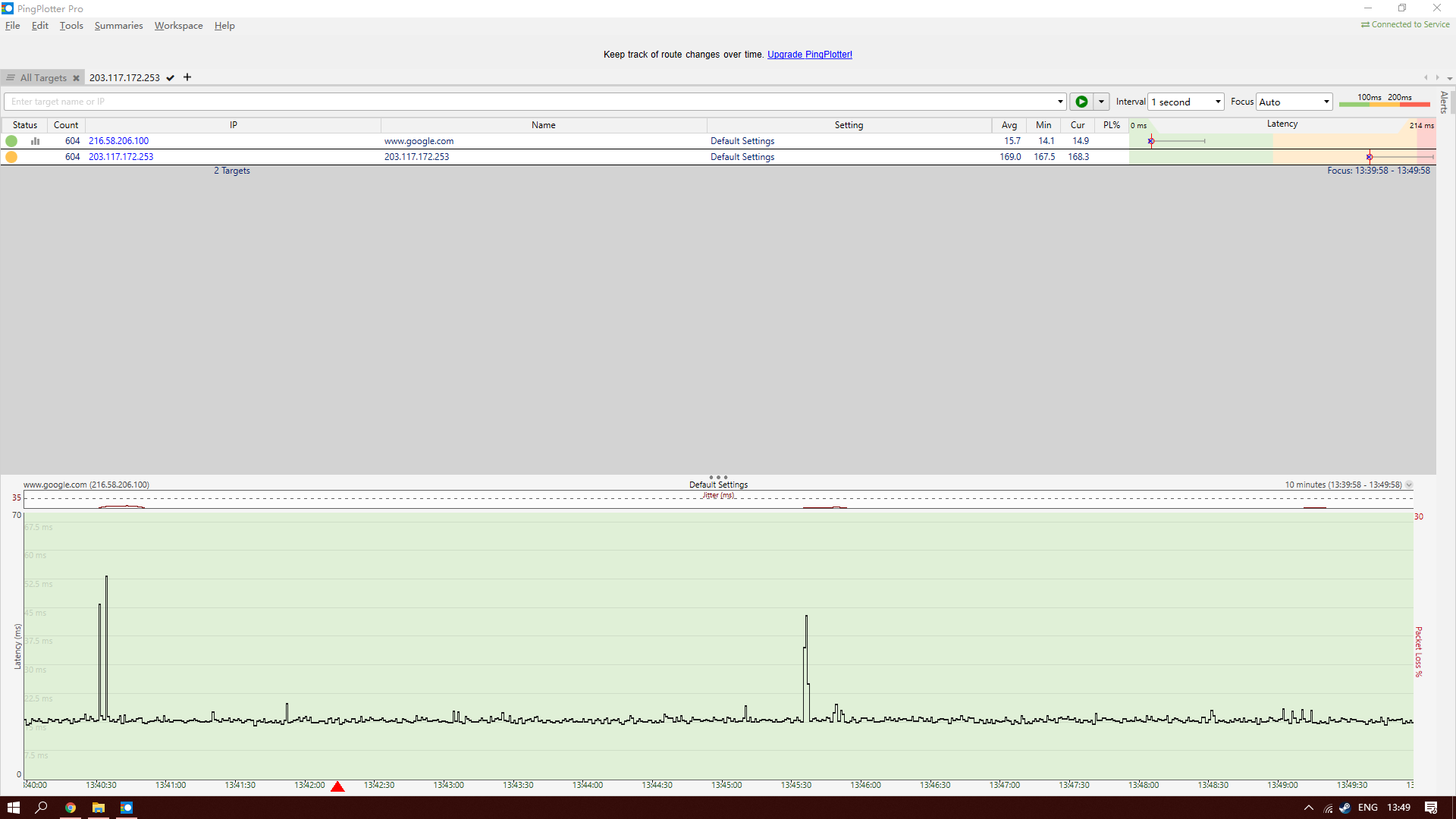

    Then I decided to use PingPlotter and trace google.com, before the Red vertical line
    Need Help! Ping Spike Every Exact Minute? 8b744ee2-766f-4aa5-9833-3a97a4a9a692?upload=true.png
    Then I saw that ping spike happening at every exact minute updating every 1 sec. I monitored the pings for a bit, including pinging my router, finding that these ping spikes happened between the pc and the router as well. this was also confirmed by using a ping monitor on my mobile, here, that my mobile using WiFi was not experiencing the ping spikes, so that this was likely to do with my pc The final approach I took was to use the WLAN Optimiserhere. This is what's behind that red vertical line

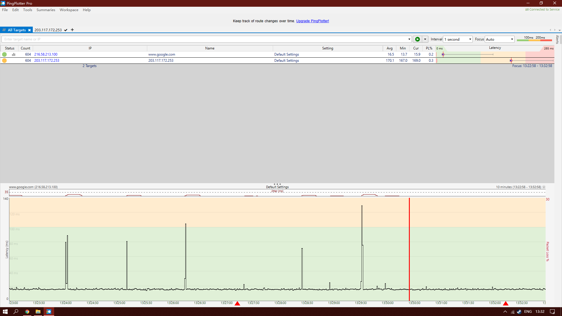

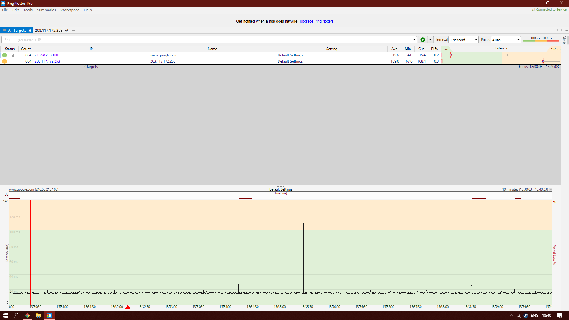

    And tracks for minutes later:
    Need Help! Ping Spike Every Exact Minute? 400db083-ed36-4eb2-8a44-7439beed2eb6?upload=true.png
    Need Help! Ping Spike Every Exact Minute? b1d4bfbb-fbed-4cf1-bbd5-1ea4c6ac1f80?upload=true.png
    It now looks like the problem has been solved, partially. Great thanks to Martin But clearly there still exists ping spikes. I want to ask that if anyone knows what is happening/what causes this ping spikes problem? And what solutions I can try? Do I have to turn on WLAN optimiser all the time or if there's a simple fix doing the same work as the optimiser? Any help is greatly appreciated.
