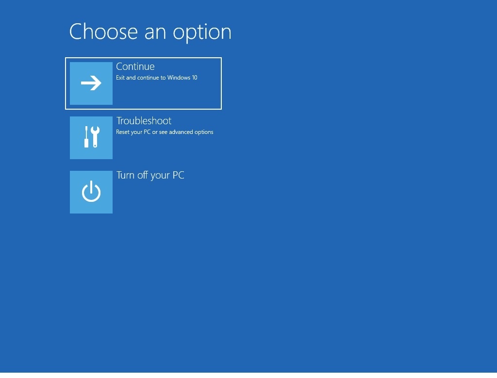

    1. On the Lock screen, press and hold the Shift key while choosing Restart from the Power menu. Continue pressing the shift key until you see the Windows Recovery environment, asking you to select an option.
      Need to convert to uefi for windows 11 73c3f294-0a67-4aa5-bf1c-05fe77dec459?upload=true.jpg
    2. Click Troubleshoot>Advanced options>Command Prompt.
    3. The computer would restart.

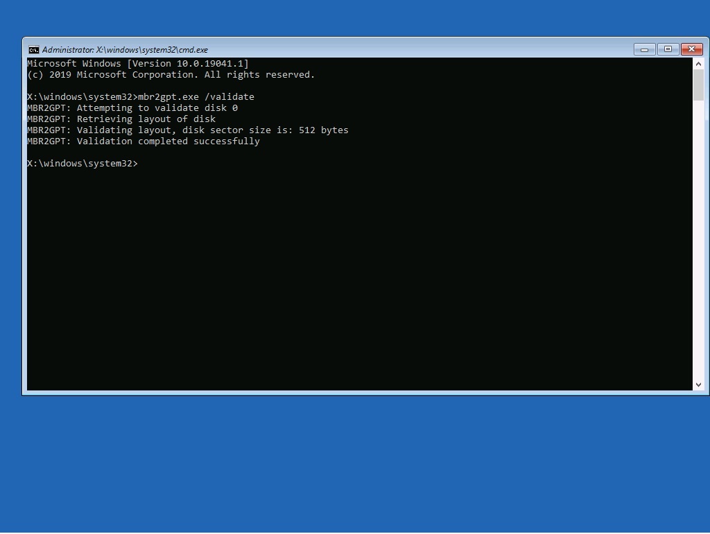

    Step 2: Validate if the MBR2GPT tool can convert your disk
    On the Command Prompt Window, our next step would be to check if the tool can convert the disk to GPT. To do this, execute the following command:
    mbr2gpt.exe /validate
    The output should tell you if the validation is successful. If the disk is validated, conversion is possible.
    Need to convert to uefi for windows 11 145ce64e-49b2-4334-9ce9-81565dcd5c7e?upload=true.jpg

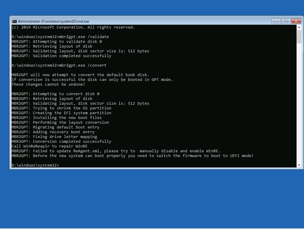

    Step 3: Convert the disk.
    The next step is to convert the disk. For that, use the /convert switch.
    mbr2gpt.exe /convert
    The process would take some minutes and tell you the output.
    Need to convert to uefi for windows 11 a7e31a64-491b-4a60-b4bd-a551595adc5a?upload=true.jpg
