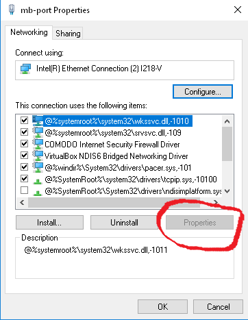

  4. network connection properties name and description are broken
    network connection properties window - property names missing

    UNPLUG ROUTER/ (AKA) MODEM. Then,

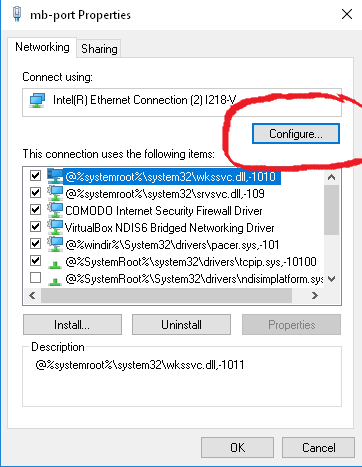

    I would click on "CONFIGURE">>"Driver" tab >>"Uninstall Device". *(From your photo above) as I mentioned and follow steps I gave you.
    NOTE: WHEN I SAY UNINSTALL THE DEVICE, I DO NOT MEAN OPEN UP YOUR COMPUTER AND REMOVE THE LAN AND WIRELESS HARDWARE CARDS. I AM TELLING YOU FROM THE POINT OF THE PHOTO YOU SHOW ABOVE IN YOUR POST, TO OPEN NETWORK ADAPTER PROPERTIES, (click on) the "CONFIGURE"

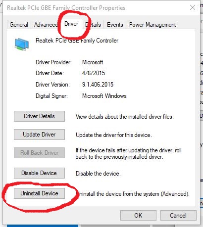

    THEN IN THE NEW POP UP WINDOW/BOX, (click on) the "DRIVER TAB" AND THEN (click on) the UNINSTALL DEVICE (at the bottom). THEN DO A DISK CLEAN UP WHICH IS WHAT I SUGGEST. THEN RESTART YOUR COMPUTER AND LOG ON AND WINDOWS WILL DETECT YOUR LAN CARD AND INSTALL
    ALL NEW DRIVERS. ONCE DONE, RE-CONNECT YOUR MODEM/ROUTER, WHEN YOU ARE CONNECTED TO INTERNET, RESTART YOUR COMPUTER AGAIN. LOG ON AND CHECK THE NEW DRIVERS IN THE PROPERTIES AND THEY WILL NO LONGER BE CORRUPT AND SHOW WEIRD FILE NAMES.

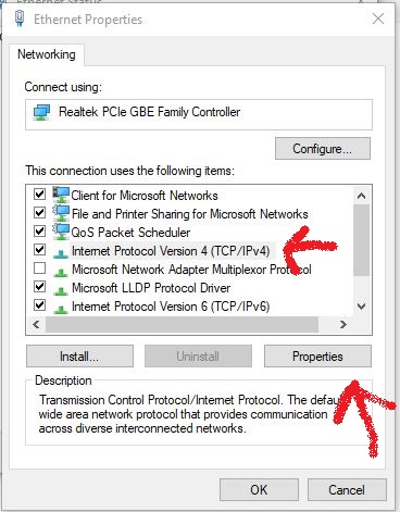

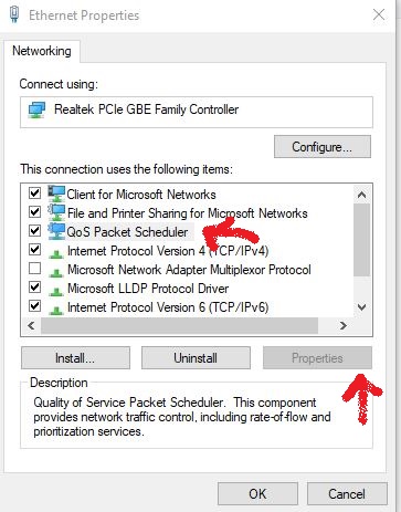

    NOTE BELOW: THAT THE "PROPERTIES" FOR EACH ITEM IN THE LIST WILL NOT BE ACTIVE FOR EACH ITEM. SOME HAVE PROPERTIES TO VIEW AND SOME DO NOT.
