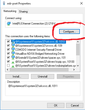

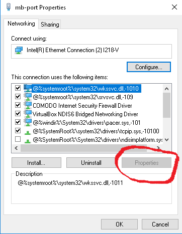

    network connection properties window - property names missing
    The Modem/Router is what the Internet Service Provider provided you for internet service or you may have bought one. It would provide the direct connect LAN connection and most likely the wireless capability. And Modem or Router, whatever you want to call
    it. It would connect to the phone line or possibly cable box like for Infinity TV and Internet.
    NIC - Network Interface Card for LAN Cable or wireless is what connects you to the Router or modem to access the internet through the internet service provider you have.
    I say to power off modem then remove the network card device. This will remove all those drivers mislabeled and assure the Device removal so you can create a new network adapter with new proper drivers so you can configure them as you can not now and to
    display proper names of each driver function. But you want to disconnect the card from internet or cut off the Wireless connection if you are not using LAN/Cat5/6 cable. Plus you will want a new network configuration once new drivers are in and when you start
    up router/modem it will do that and connect you to internet.
    UNPLUG ROUTER/ (AKA) MODEM. Then,
    I would click on "CONFIGURE">>"Driver" tab >>"Uninstall Device". *(From your photo above) as I mentioned and follow steps I gave you.
    NOTE: WHEN I SAY UNINSTALL THE DEVICE, I DO NOT MEAN OPEN UP YOUR COMPUTER AND REMOVE THE LAN AND WIRELESS HARDWARE CARDS. I AM TELLING YOU FROM THE POINT OF THE PHOTO YOU SHOW ABOVE IN YOUR POST, TO OPEN NETWORK ADAPTER PROPERTIES, (click on) the "CONFIGURE"

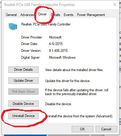

    network connection properties name and description are broken fe7b8de5-1f7d-41b8-853e-8114bc968812.png
    THEN IN THE NEW POP UP WINDOW/BOX, (click on) the "DRIVER TAB" AND THEN (click on) the UNINSTALL DEVICE (at the bottom). THEN DO A DISK CLEAN UP WHICH IS WHAT I SUGGEST. THEN RESTART YOUR COMPUTER AND LOG ON AND WINDOWS WILL DETECT YOUR LAN CARD AND INSTALL
    ALL NEW DRIVERS. ONCE DONE, RE-CONNECT YOUR MODEM/ROUTER, WHEN YOU ARE CONNECTED TO INTERNET, RESTART YOUR COMPUTER AGAIN. LOG ON AND CHECK THE NEW DRIVERS IN THE PROPERTIES AND THEY WILL NO LONGER BE CORRUPT AND SHOW WEIRD FILE NAMES.

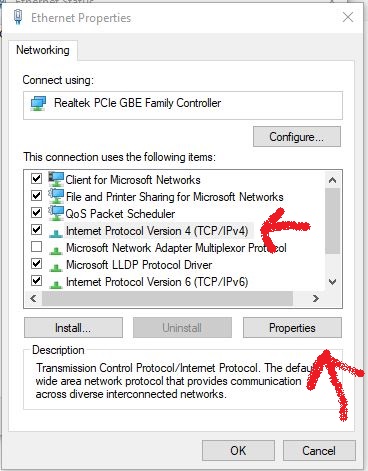

    network connection properties name and description are broken 056f7ec5-1609-43a7-8b70-1769cf5ebc5f.jpg
    NOTE BELOW: THAT THE "PROPERTIES" FOR EACH ITEM IN THE LIST WILL NOT BE ACTIVE FOR EACH ITEM. SOME HAVE PROPERTIES TO VIEW AND SOME DO NOT.

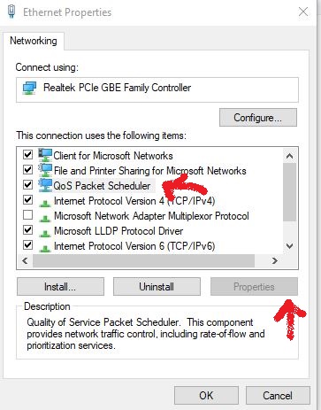

    network connection properties name and description are broken 6e6e34f8-428a-4e56-b72a-afdc62141140.png
    ON MINE EXAMPLE:
    network connection properties name and description are broken 54bc4a82-f041-4dcb-8388-355ae6e4f51c.jpg
    network connection properties name and description are broken 29c534c2-87ba-4b29-bd5b-a0bb3d95c03b.jpg
