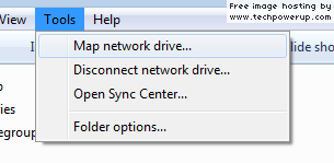

    I have used a small handful of applications that just won't open a \\host\share\file.ext
    Annoying, but there may be a workaround, try mapping the share to a drive letter:
    In Explorer, Tools > Map network drive...
    network error when attempting to open an .exe file from network share map-network-drive-1.png

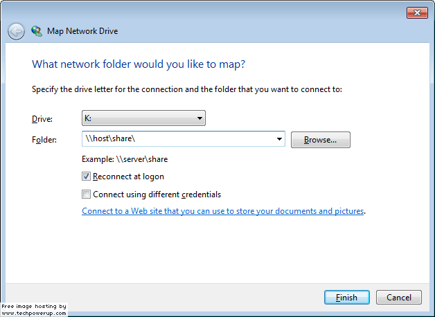

    Then choose an unused drive letter, and the shared folder.
    network error when attempting to open an .exe file from network share map-network-drive-2097.png
    This will work for most programs as it'll see K:\kitchen.kit
    Jizzler, Jan 14, 2021
