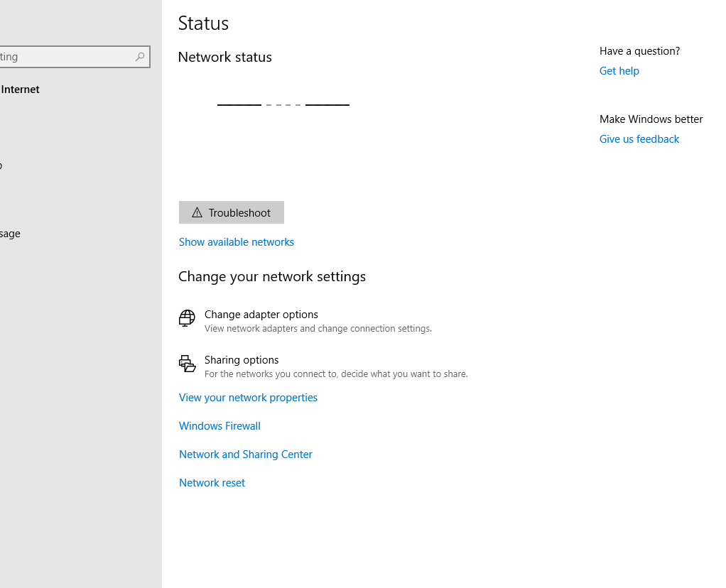

  1. buck_531 Win User
    Network status appears as dash lines and sound does not work.
    so i was cleansing up my pc I turned it off only for it to not detect sound or any wifi. the network when clicked on shows dashed lines. Ive tried both network resetting, restarting, re enabling, etc but nothing seems to work. most of the options to changed things are grayed out and don't work or are non equidistant. Network status appears as dash lines and sound does not work. 24924bb9-f89d-4e72-8f78-ad076cd2f0da?upload=true.png Network status appears as dash lines and sound does not work. b72eb363-f30d-4e5d-b3db-fd9cf9164ed1?upload=true.png
    buck_531, Sep 26, 2019

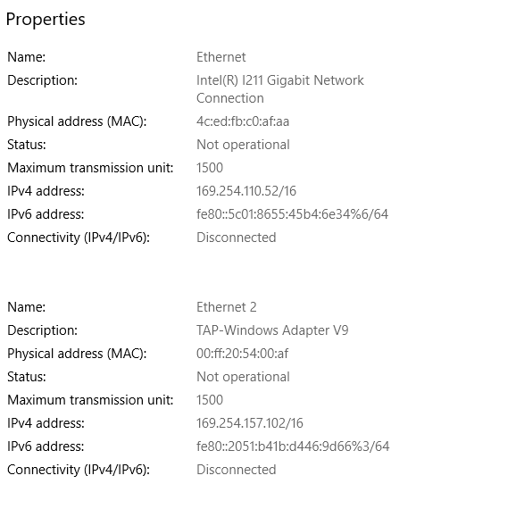

  2. Wifi status appears as a dashed line - cannot find networks (though my computer connects to remembered networks and has internet)
    Horizontal dashed line in Windows 10 network status!
    We have experienced this behaviour also on some of our company laptops last week.
    This behaviour can cause Office 365 to not find the license server anymore, if you take a look on your office account in for example word it will say: No internet connection.
    However you are still able to browse the web and able to ping several webservices.
    Although a restore can help with this issue, this is not the root cause.
    In our case a restore did not help, neither did a firmware, bios and driver update for the network adapters.
    We deinstalled several software packages but this was also not helpful.
    The solution was pretty simple:
    The network list service was disabled in services, this was most likely the case after a windows update or software that has been installed (for example a VPN software solution)
    We suspect it to be because of a Windows update since we had this issue on several laptops in different countries all within a certain time frame (no software was installed during that timeframe, only windows updates)
    Once we set the network list service back to manual startup and started the service the horizontal dashed line disappeared and
    we were able to fully function again.
    Steef_1202, Sep 26, 2019
