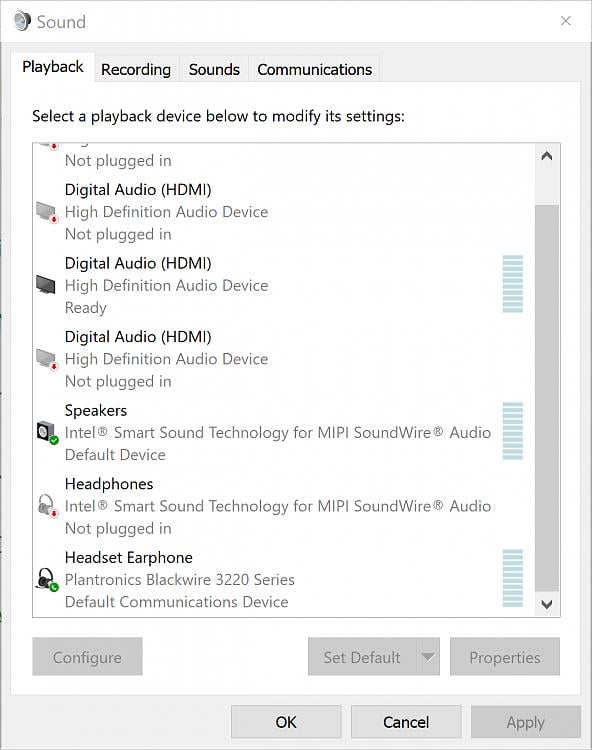

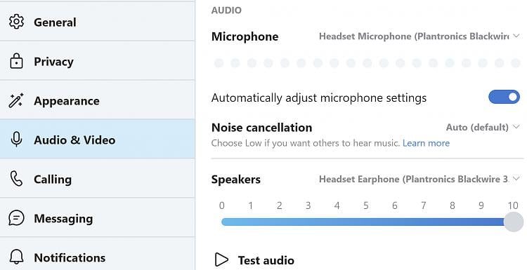

    Hi all, I use both Skype and Telegram for voice calls. With Skype it works fine, the app's audio setting is set to the Plantronics headset while Windows Sound setting is set to the Windows speakers/mic, and when I place/receive Skype calls the audio/mic comes out thru my Plantronics headset. In Telegram, even if the app's audio setting is set to Plantronics, the audio/mic comes out thru the laptop's speakers/mic, forcing me to set the Windows Sound setting to Plantronics Default each time I want to place/receive a call. Any idea why this is happening? Maybe it's a Telegram bug. I'm using Telegram Desktop latest version 3.5.1. I'm attaching a screenshot of Skype, Telegram and Windows sound settings as explained above.
    No audio from bluetooth headset or speaker unless testing mic 359009d1644102165t-telegram-desktop-audio-using-speakers-not-headset-skype.jpg
    No audio from bluetooth headset or speaker unless testing mic 359010d1644102187t-telegram-desktop-audio-using-speakers-not-headset-telegram.jpg
    No audio from bluetooth headset or speaker unless testing mic 359011d1644102204t-telegram-desktop-audio-using-speakers-not-headset-system.jpg
