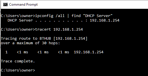

  3. Bree Win User
    Rogue DHCP Server is running in a VM
    Well, the simplest way to track down where this DHCP server is would be to use the TRACERT command. If it takes one hop to find it then it is on your router, as mine is.
    'No DHCP server was found', 'The DHCP server isn't responding'. 268859d1583158256t-rogue-dhcp-server-running-vm-image.png
  4. Bowlsys Win User
    My router- gateway address is 192.168.0.1
    - - - Updated - - -
    Just to explain how I know that this is a rogue DHCP Server, This is the result I receive after typing the Ipconfig commend:-
    C:\Users\BSAdmin\Desktop>ipconfig /all | find /i "DHCP Server" DHCP Server . . . . . . . . . . . : 192.168.58.254
    As you can see this address is not part of my subnet.
    Bowlsys, May 26, 2025
