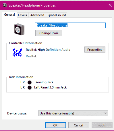

  1. No enhancement tab
    I always used the enhancement tab on my previous Toshiba notebook with Windows 7, but when I got my new HP notebook with Windows 10 (and before any updates), I checked the enhancement tab but it wasn't there. I thought that maybe because I didn't updated my notebook.
    But even after I did all the required updates ,still, there's no enhancement tab.
    (I have Realtek High Definition Audio driver, and I believe that the simple enhancement tab is usually supported by this driver, right?!) No enhancement tab ef56f84d-2741-4167-9874-f43db2796019?upload=true.png
    ThomasMichel1, Jul 14, 2018
  2. Mayra Aqu Win User
    no enhancements tab on my speaker properties HP windows 10
    Hi Manuelde,
    Outdated audio driver is one of the usual caused why the enhancements tab is not appearing on the speakers properties. There are also audio drivers that don't have an enhancement tab.
    To isolate the root cause of the issue, we need additional information:
    • Which audio driver are you using?
    • Were you able to use the enhancement tab before?
    • Did you make any changes prior to the issue?
    As an initial troubleshooting, we suggest uninstalling the driver using the steps below:
    • Open Device Manager.
    • Right-click (or tap and hold) the name of the device, and select
      Uninstall.
    • Restart your PC and Windows will attempt to reinstall the driver.
    Update us with the outcome so we can provide further assistance.
    Mayra Aqu, Jul 14, 2018
