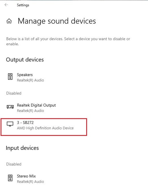

    Windows Or AMD Installs Sound Driver For Monitor With No Audio Ports
    I searched and all I could find was issues with no sound from monitor. My issue is the reverse, well sort of. For some reason Windows or AMD installs audio driver for my new monitor with no audio ports. Monitor is an Acer SB272 EBI 27" Full HD as listed in my PC specs. When I booted up the first time Windows or AMD makes the monitor sound my default sound device and the result is no sound. I changed the sound settings and disabled the monitor sound device. I can't figure out is why a sound driver is installed for a monitor with no sound or mic ports. This is coming from a clean windows 10 install. The monitor sound driver wasn't there until I put my XFX video card back in. I didn't install any video drivers. Any ideas as to why the driver was installed?
    No sound from monitor or pc after installing new updates and new sound driver 394745d1691156910t-windows-amd-installs-sound-driver-monitor-no-audio-ports-monitor-sound.jpg
    Turtley, Oct 10, 2024
