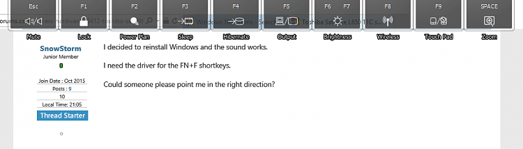

    Toshiba Satellite L650 11C sound issues
    If you're talking about this that appears at the top of the screen when you press FN...
    No sound on Toshiba Satellite 115114d1485975251t-toshiba-satellite-l650-11c-sound-issues-toshibaflashcards.png
    ...then it's called 'Toshiba Flash Cards'. It is installed as part of the 'Toshiba Value Added Package'. It is essential you find and install the right one for your model. There is a different 'Value Added Package' tailored specifically for each model in the Toshiba range.
