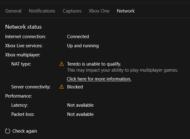

    I just bought Forza Horizon 4 but I cannot connect to the "Horizon Life". So I checked my Network in the XBox App and it displays this:

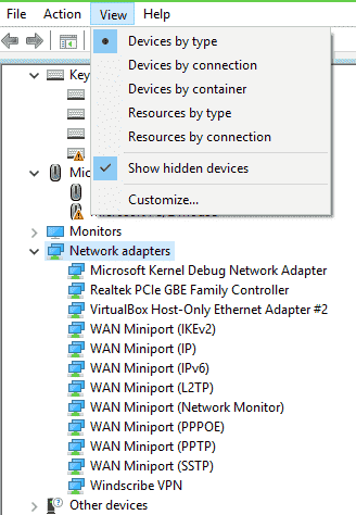

    I already clicked on "Click here for more information" but that didn't help. I tried to search online for another solution and came across that I just have to reinstall the driver for Tredeo in the Device Manager:
    But if i follow the instruction and try to "Add Lagacy Hardware" in the Device Manager it doesn"t show an option to install that driver/adapter. I selected Microsoft as the manifacture but it doesn't show anything related to "Tredeo". And I cannot find any solution on how to install Tredeo if it isn't installed. I also tried to configure tradeo via netsh but still nothing changes. Any public support page from Microsoft/Xbox couldn't help me either.

    Teredo Driver
    Hi Austen,
    There are few steps to install Teredo Tunneling Adapter. We recommend following these steps to have it downloaded:
    • Go to Device Manager. Then click the category Network Adapters.
    • Then go to Action tab, and choose Add legacy hardware from the list of choice.
    • Click Next.
    • Then click Next again at the recommended option. Then click
      Next
      one more time.
    • Scroll down a little bit to locate Network adapters option, and then click
      Next to continue.
    • On the left side of the pane, choose Microsoft. On the right side of the pane, choose
      Microsoft Teredo Tunneling Adapter. Then click Next to continue.
    • Click Next to start the installation.
    • Wait for the notification window to appear. When you see this Window, your
      is successfully installed.
    Let us know if you need any other help.
    Regards.
    Darian Tab, Sep 30, 2018
