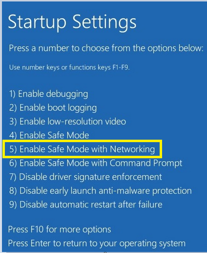

    The changes made on your computer may have disabled your local account, that's why the login screen doesn't load. For us to diagnose and address this problem, we suggest starting your computer in safe mode. Since we can't get to the Settings option, let's
    force your computer to load the startup repair window so we'll be able to proceed with safe mode and enable back the items that were disabled. Here's how:
    • Hold the Shift key down while you select Power > Restart.
    • Your computer will restart to the Choose an option screen.
    • Once the page appear, select Troubleshoot > Advanced options > Startup Settings > Restart.
    • When your computer restarts, the options shown in the photo below should show up:
    No users to select at startup screen to login. 9ce0d795-7a2d-4b39-a6e6-1d43a113ccf7.png
    5. Select option 5 to enable Safe Mode with Networking.
    6. Sign in to your account while in Safe Mode and enable back the items that were disabled.
    7. Restart your computer to return to a normal boot.
    Please update us with the result so we can assist you in case you need further help.
