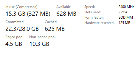

    In task manager I can see 10GB under non-paged pool:

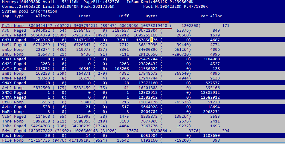

    Using poolmon I see the following:
    Now I can see this Tag named PsIn taking 10GB on non-paged pool.

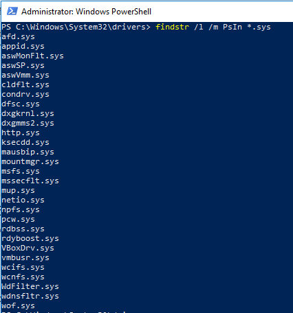

    From here I go to my drivers folder C:\Windows\System32\drivers and search for that tag in the drivers folder:
    Where do I go from here??? I can see many drivers includes this TAG.
