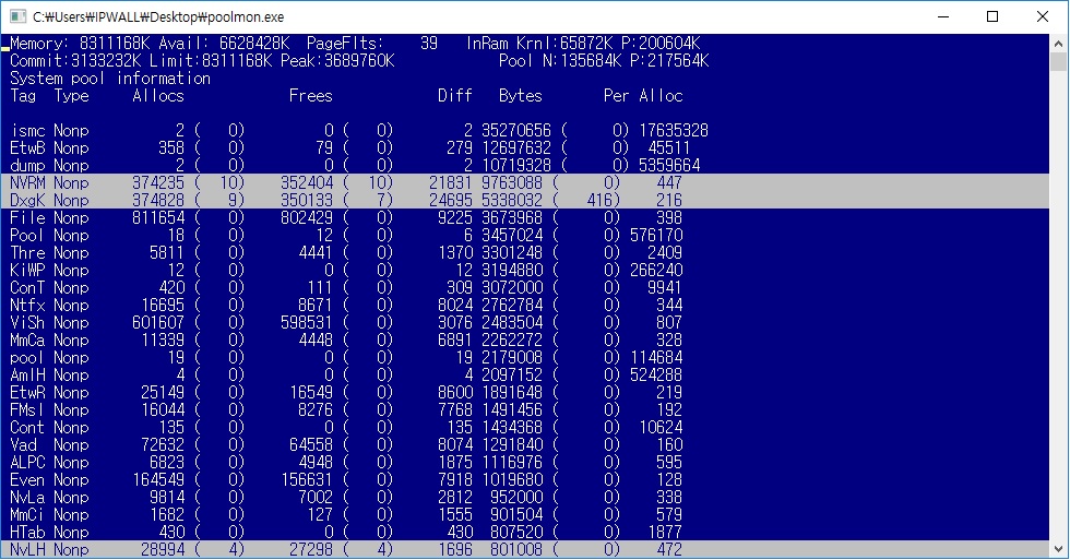

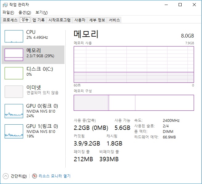

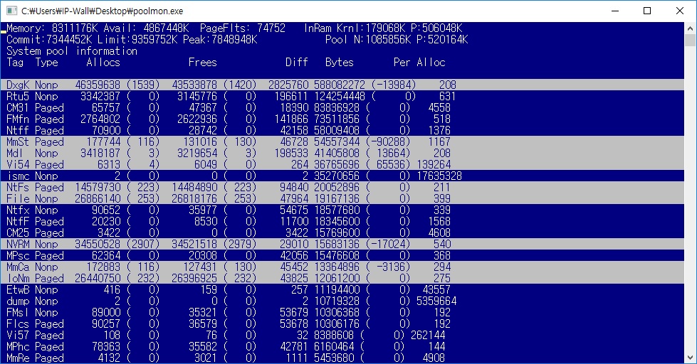

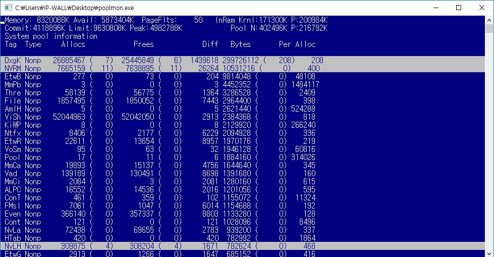

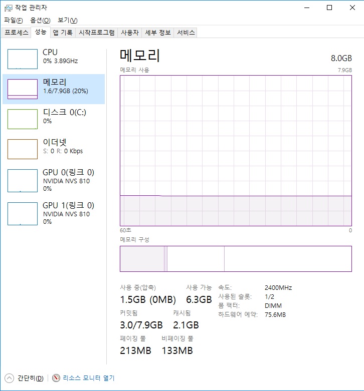

  4. Non Paged Pool Quota and Size as 1
    Continued increase in Non-paged pool.
    Hello.
    I am using multiple monitors with NVS810.
    This is a technical inquiry as there is a memory leak during use.
    Three PCs tested and all found memory leaks.
    Specifications : I7-7700K I7-8700K I7-8700K
    ( 16299.248, 16299.248, 16299.371)
    RAM: 8GB
    Motherboard : Z270-A
    OS : Windows 10 pro x64
    Graphic driver: 386.01 390.77 391.33
    Using monitor : 6 4 10
    RAM, Motherboard, OS are identucal, and Graphic driver versions are tested differently.
    I tried mant things.
    1. Change the NDU registry value (1 → 4)
    2. Disable virtual memory.
    3. Disable integrated graphics.
    4. Disable Windows defender.
    Also, use the 'Poolmon.exe' program, I found that 'dxgkrnl.sys' rise abnormally.
    and I tried to install it with the latest version of 'Direct X'. but the same is happening.
    I7-7700K Monitor - use 6
    Non Paged Pool Quota and Size as 1 ff082693-127a-48a6-9732-141f51c0fc61?upload=true.jpg
    Non Paged Pool Quota and Size as 1 efa1b00e-cdba-4697-80be-1fa853b6040d?upload=true.jpg
    i7-8700k Monitor- use 4 (Reboot in 1 hour)
    Non Paged Pool Quota and Size as 1 fb31594e-e35f-4794-8e47-7728b837f82b?upload=true.jpg
    Non Paged Pool Quota and Size as 1 5e921fae-4a9b-4dc5-895e-0efbc1e66044?upload=true.jpg
    I7-8700k Monitor- use 10
    Non Paged Pool Quota and Size as 1 85e61acc-8cd0-4ec4-b360-b030a137e348?upload=true.jpg
    Non Paged Pool Quota and Size as 1 485dd997-91dc-4cd3-bea4-a64182fcb9b5?upload=true.jpg
    In AMD W600 have no memory leak. It is only discevered on NVS810.(It's the same specification.)
    The attached picture is 'Specifications', 'Non-paged pool', 'Dxgk of poolmon.exe'.
    and the low 'Non-paged pool' was within an hour.
    If it's running all day, 'Non-paged pool' rises 200~300MB.
    My situatiin can not turn off PC. Plz your help.
    * If you use the nvs810 'Mosaic to Grouping', this seems to be happening
    Release 'Mosaic to Grouping' → 'Non-paged pool' does not rise.
    * NVS810 slot 1~8, 1~4 same slot, 5~8 same slot.
    If different slots are used, 'Non-paged pool' rise.
    ex] NVS810 slot 1,2,3,4 → 'Non-paged pool' does not rise.
    NVS810 slot 1,2,5,6 → 'Non-paged pool' rises.
    준식_김, May 23, 2020
