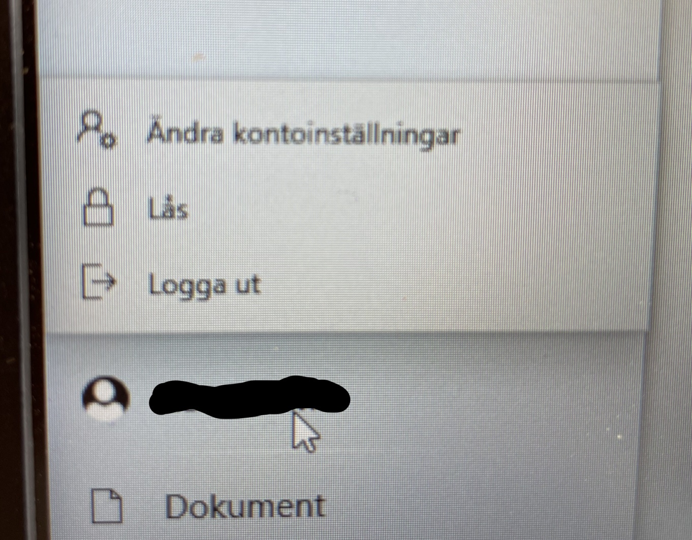

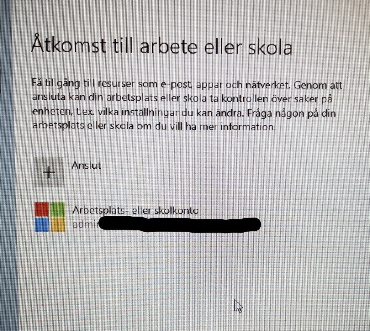

  4. Patrik S_ Win User
    Non-profit Azure AD Account PC Login Issue
    Login using Azure AD account instead of local account
    Hi!
    I am trying to find the recommended way to go from using a local account to a Azure AD account for log-in on Windows 10. I have a computer with a local admin account. I used this to create a work account. It seems to go well and I can find the computer listed in Azure AD as AD registered and MDM connected to Microsoft Intune.
    So far so good. Now I am stuck not able to change account and log-in with a domain account instead of the local user. There is simply no option to switch user. Not in the windows menu as the picture show or on the login screen. I have seen a number of threads on this matter and tried some solutions so far with no luck.
    These issues gets me wonder what the correct procedure is to go from local account to a Azure AD account without having to reinstall windows?
    It is Windows 10 Home which some mention is not possible to Azure AD join. It seems to work to get to status Azure AD registered and into Intune though.

    Patrik S_, Nov 27, 2022
