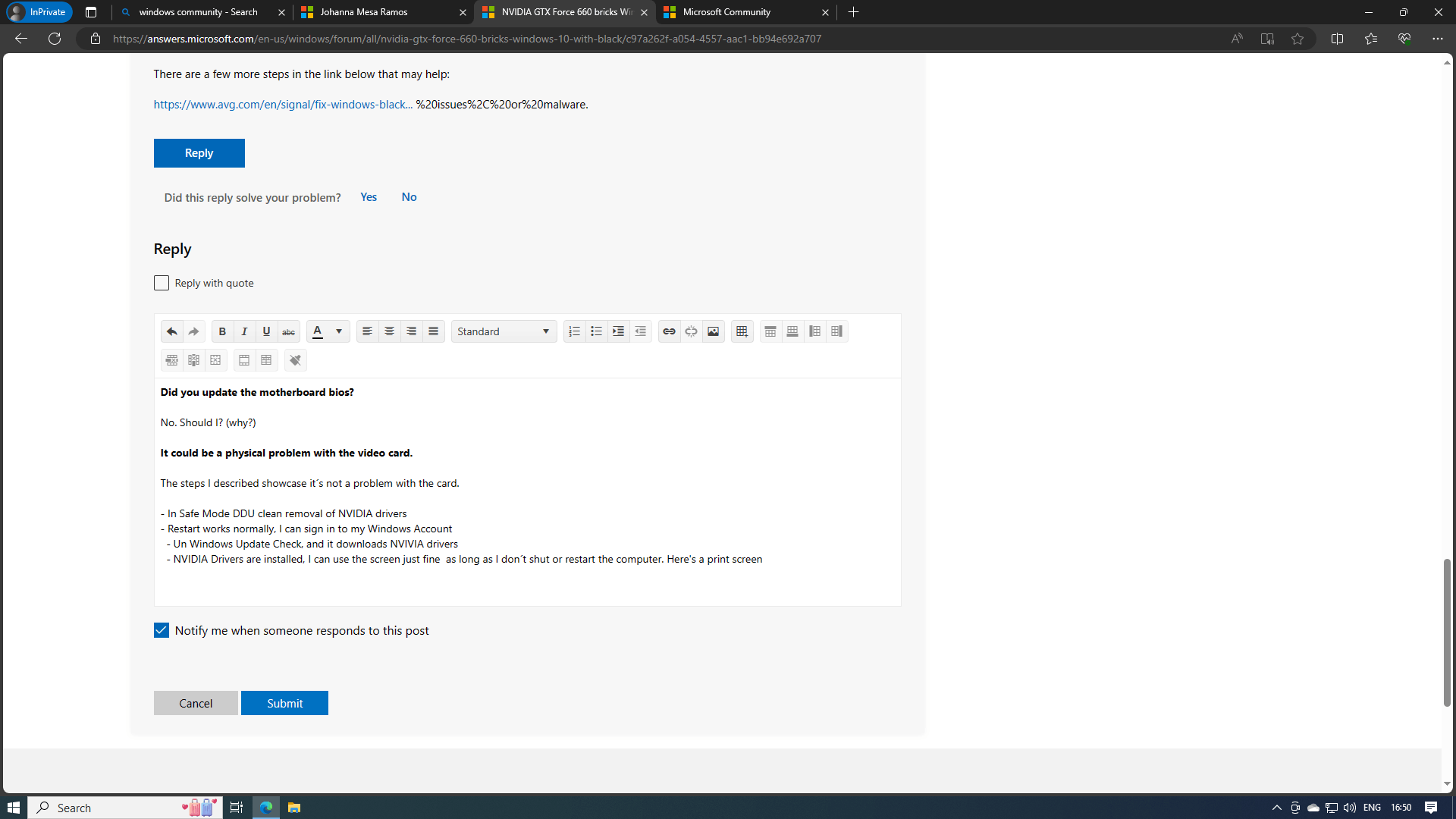

    Did you update the motherboard bios?
    No. Should I? (why?)
    It could be a physical problem with the video card.
    The steps I described showcase it´s not a problem with the card.
    - In Safe Mode DDU clean removal of NVIDIA drivers
    - Restart works normally, I can sign in to my Windows Account
    - Un Windows Update Check, and it downloads NVIVIA drivers
    - NVIDIA Drivers are installed, I can use the screen just fine as long as I don´t shut or restart the computer. Here's a print screen
    NVIDIA GTX Force 660 bricks Windows 10 with Black Screen of Death TOvySLsm3kNorwuV30aJ4HdLVZmJayQt9JABF0IEDAl9zH9BIQJMM6gEStjUxAp7FtAQdIXs3chen%2FzP%2BRknx0OUo%3D.png
    Problem comes up when I shut the computer off after I have installed the drivers. It dies on start up, right when the window logos is supposed to appear, I get black screen of death.

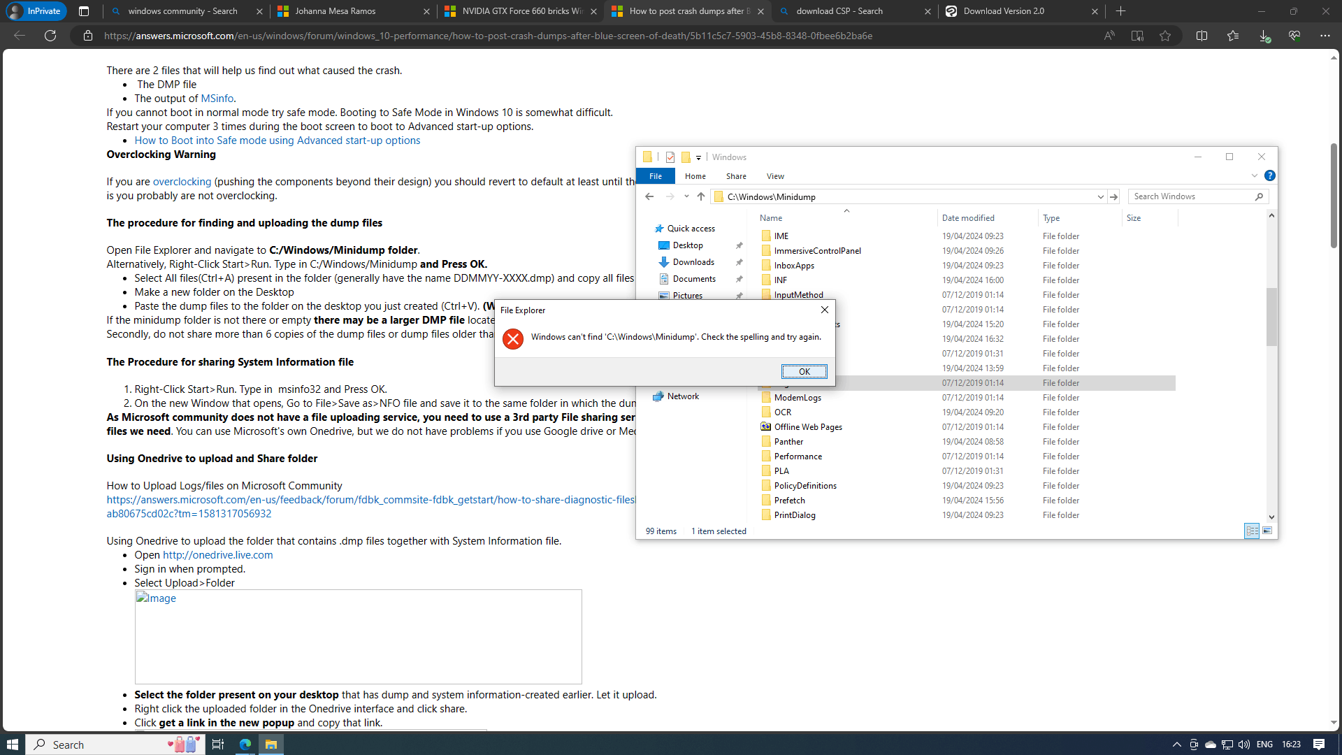

    Here are the event logs , sysinfo is in there as well.
    There is no Minidump folder that I can share:
