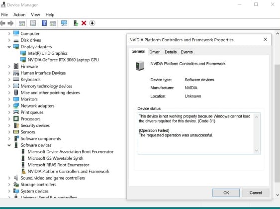

  3. antares Win User
    Nvidia Platform Controllers and Framework/Code 31/Device Manager
    When updating the Nvidia driver to latest one I keep getting the error Code 31 in Device Manager. My system is Windows 10 Home, fresh install and I install drivers cleanly. I googled and found the conflict could be related to Memory Integrity in Core Isolation (Windows Device Security settings), but I have it OFF. Any hints? thanks
    NVIDIA Platform Controllers and Framework error 64642227t-nvidia-platform-controllers-framework-code-31-device-manager-photo_2022-10-01_13-28-04.jpg
    UPDATE: In another WIndows 10 PC with the same Nvidia driver version installed
    there are no conflicts in Device Manager, and additionally, there is no "Nvidia Platform Controllers and Framework" component under "Software Devices", so maybe I can just uninstall this conflicting device by right clicking/Uninstall without any harm?
