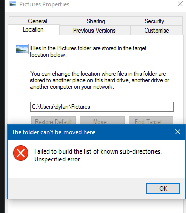

  2. Djdp2 Win User
    Can not Restore Default location of picture folder "Failed to build the list of known sub-directories"
    Hi there,
    I am currently trying to change the location of my pictures folder to the default folder since I do not want it on my onedrive, but when I click on "Move" on the folder's properties, it comes up with the error of "Failed to build the list of known sub-directories". This still shows up when I click "Restore Default"
    OneDrive has kidnapped my pictures directory and I can not restore it to default help please. a558f477-f0a2-442b-901e-0e1d21fe9e1d?upload=true.png
    I have tried:

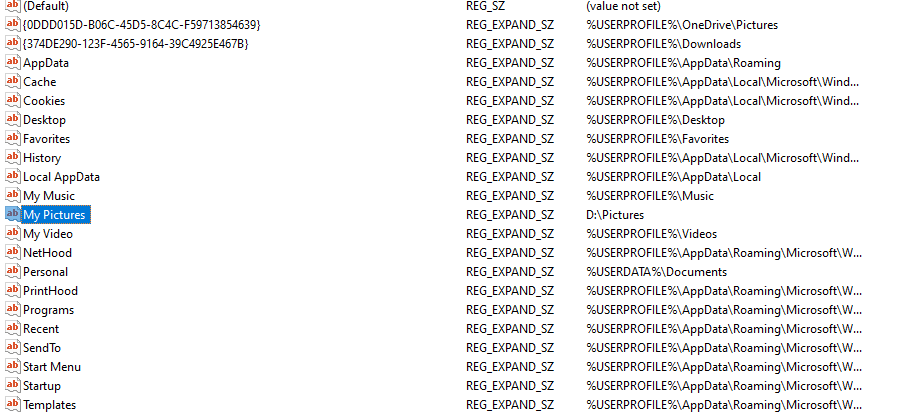

    I have even tried changing the key in regedit yet it still forces my picture folder into the onedrive folder.
    OneDrive has kidnapped my pictures directory and I can not restore it to default help please. 593a3707-4c9e-48e3-b668-f653d8a1362f?upload=true.png
    I am running Windows 10 21H2 Build 19044.1889
    Djdp2, Jun 24, 2024
  3. GGG4444 Win User
    ONEDRIVE IS A VIRUS - How do I restore my Document, Pictures, etc to defaults?
    Cute response but a pathetic answer since it does not recognize the simple issue that when a program is uninstalled it should remove the redirects that it places in the registry. By not providing the basic ability to restore the default directories, Microsoft
    OneDrive has deviated from the norms provided by the plethora of decent software developers on the market today.
    I can only imagine that the refusal of Microsoft to remove all registry entries, refusal to restore default locations for documents and pictures, and refusal to allow one to use the built in 'location' changes in windows explorer settings is an intentional
    way to force people to use OneDrive. In doing so, Microsoft has committed what I consider to be much like what a 'hijack' program does by making it nearly impossible to properly remove OneDrive.
    Fortunately, although tedious and time consuming, I have found a solution.
    1. Run Regedit
    2. Create a backup of the registry (in case you make a bad mistake)
    3. Do a search for the onedrive folder. (it would default to C:\users\XXXX\OneDrive\ [xxxx = your actual username])
    4. Open every entry and delete the portion from XXXX\OneDrive\ to be XXXXX\ (remove OneDrive from the path)
    5. close the registry
    6. reboot
    And by the way, I am quite familiar with OneDrive and use of Microsoft Windows tools (like regedit).
    GGG4444, Jun 24, 2024
