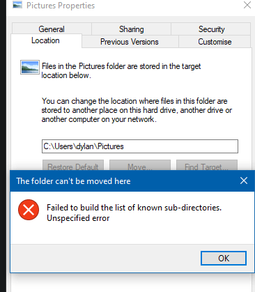

    Can not Restore Default location of picture folder "Failed to build the list of known sub-directories"
    Hi there,
    I am currently trying to change the location of my pictures folder to the default folder since I do not want it on my onedrive, but when I click on "Move" on the folder's properties, it comes up with the error of "Failed to build the list of known sub-directories". This still shows up when I click "Restore Default"
    OneDrive has kidnapped my pictures directory and I can not restore it to default help please. a558f477-f0a2-442b-901e-0e1d21fe9e1d?upload=true.png
    I have tried:

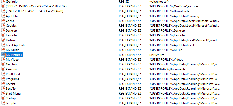

    I have even tried changing the key in regedit yet it still forces my picture folder into the onedrive folder.

    Fortunately, although tedious and time consuming, I have found a solution.
    1. Run Regedit
    2. Create a backup of the registry (in case you make a bad mistake)
    3. Do a search for the onedrive folder. (it would default to C:\users\XXXX\OneDrive\ [xxxx = your actual username])
    4. Open every entry and delete the portion from XXXX\OneDrive\ to be XXXXX\ (remove OneDrive from the path)
    5. close the registry
    6. reboot
    And by the way, I am quite familiar with OneDrive and use of Microsoft Windows tools (like regedit).
