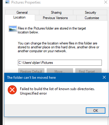

    Can not Restore Default location of picture folder "Failed to build the list of known sub-directories"
    Hi there,
    I am currently trying to change the location of my pictures folder to the default folder since I do not want it on my onedrive, but when I click on "Move" on the folder's properties, it comes up with the error of "Failed to build the list of known sub-directories". This still shows up when I click "Restore Default"

    I have tried:
    • Giving me full permission on the onedrive folder
    • Taking ownership of the folder
    • Running SFC Scannow

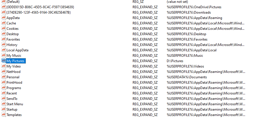

    I have even tried changing the key in regedit yet it still forces my picture folder into the onedrive folder.

    I am running Windows 10 21H2 Build 19044.1889

    1. Run Regedit
    2. Create a backup of the registry (in case you make a bad mistake)
    3. Do a search for the onedrive folder. (it would default to C:\users\XXXX\OneDrive\ [xxxx = your actual username])
    4. Open every entry and delete the portion from XXXX\OneDrive\ to be XXXXX\ (remove OneDrive from the path)
    5. close the registry
    6. reboot
    And by the way, I am quite familiar with OneDrive and use of Microsoft Windows tools (like regedit).
